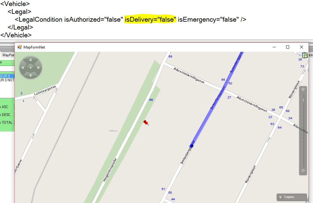

So here we go... though I can't provide a 100% solution I have new info about this (thanks to Frank for the analysis):
The area we are refering to seems to be restricted by so-called gates.
Let's start with some screenshots from an internal tool:
entering from the north doesn't work because there are turning restrictions which prevent us from getting into the delivery area.
Entering from the south is also impossible due to the same turning restrictions.
We successfully entered the area if we allow violations of turnings:<br />        &lt;Course&gt;<br />            &lt;Maneuver considerTurningBans=&quot;false&quot; uTurnCost=&quot;5000&quot;/&gt;<br />        &lt;/Course&gt;
<Course>
<Maneuver considerTurningBans="false" uTurnCost="5000"/>
</Course>
But probably it is not a sufficient approach to enable this kind of flexibility.

If you set the deliveryFlag to false the linking favours a segment which can be reched without such problems:
(Linking successful to the segment in the east - further away but easier to reach)
Does this help?

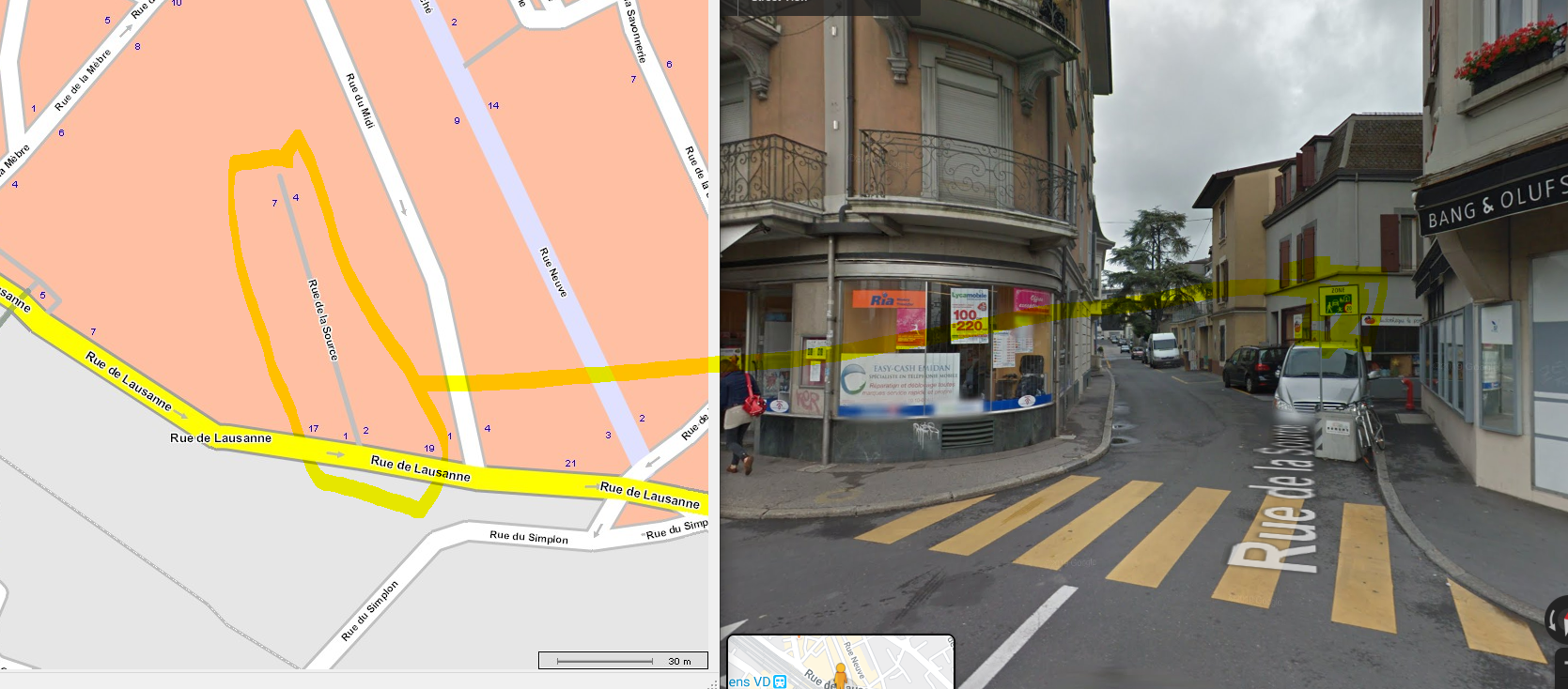

looks like the road is forbidden in the TOMTOM data:
Left: map data TOMTOM : segment &quot;rue de la source&quot; looks like a pedestrian road. Not applicable for &quot;ordinary&quot; cars.
Left: map data TOMTOM : segment "rue de la source" looks like a pedestrian road. Not applicable for "ordinary" cars.

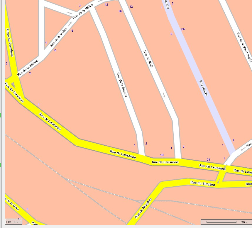

In the HERE map it is a regular road.
HERE map
HERE map
Maybe you can provide your exact XML request so we can reproduce and "tune" it?

we also have a problem with the error message "cannot calculate route (concerning leg X)".
We have already tried a little bit with the parameters "isDelivery", "isAuthorized" and "isEmergency".
Generally we noticed that by setting these parameters more routes could be calculated. However, we also had a few cases where setting the "isEmergency" parameter resulted in an incorrect calculation.
Now we have a route where setting the "isDelivery" parameter leads to an error.
We have also tried setting "<Maneuver considerTurningBans="false" uTurnCost="5000"/>" which did not help.
I put the route
waypoints.txt
waypoints
(262 Bytes) Downloaded 536 times
and the XMLProfileSnippet
Profile.xml
XMLProfileSnippet
(1.52 KiB) Downloaded 567 times
in the attachment.
Can you help us to fix the problem?
