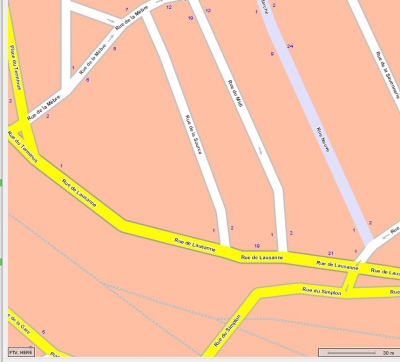

I'm facing the same error "Cannot calculate route concerning leg *number*" with the following address:
Rue de la Source 5
1020 Renens
https://goo.gl/maps/8dyJykFku9ZmCArSA
I have tried the suggestions:
http://devblog.ptvgroup.com/2014/01/10/ ... -vehicles/
https://xserver.ptvgroup.com/forum/post ... 552#pr1950
But none worked for me.
But, it works by changing the delivery flag: alternating this boolean parameter switches from error (isDelivery=true) and success (isDelivery=false)
Thank you in advance for your support.
Pedro Diogo

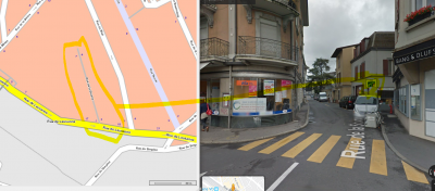

Hello Pedro,
looks like the road is forbidden in the TOMTOM data: In the HERE map it is a regular road. Maybe you can provide your exact XML request so we can reproduce and "tune" it?

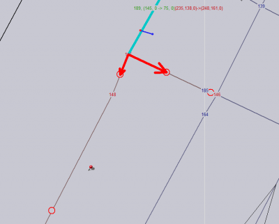

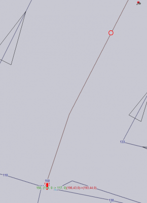

Hello Pedro,
here's the result of our development team's analysis:
Sorry for that output - sounds like this case needs a special manual treatment.
PS: I also want to emphasize that this isn't a but of the engine.
So while violations can help with a spcific category of restrictions this does not apply in your scenario.The violation concept does not help here as this is only valid for segment attributes like blockings. For geographic restrictions used here there is no possibility other than modifying them (e.g. including France to the allowed countries).
In this special case you can play around with the linking. If you set the link type of the second waypoint to "NEXT_NODE" than it works as the waypoint is linked a bit more east. Or you can "move" the waypoint a bit more away from the border. In any case you have to handle such waypoints manually.

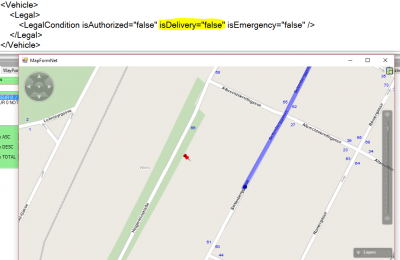

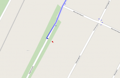

we also have a problem with the error message "cannot calculate route (concerning leg X)".
We have already tried a little bit with the parameters "isDelivery", "isAuthorized" and "isEmergency".
Generally we noticed that by setting these parameters more routes could be calculated. However, we also had a few cases where setting the "isEmergency" parameter resulted in an incorrect calculation.
Now we have a route where setting the "isDelivery" parameter leads to an error.
We have also tried setting "<Maneuver considerTurningBans="false" uTurnCost="5000"/>" which did not help.
I put the route and the XMLProfileSnippet in the attachment.
Can you help us to fix the problem?
With kind regards
Lennart Kampshoff
