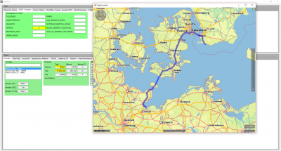

I successfully requested the ferry:
https://xroute-eu-n-test.cloud.ptvgroup ... /ws/XRoute
neutral ferry malus.<br />Time: 5h:48m <br />Distance 299km
Time: 5h:48m
Distance 299km

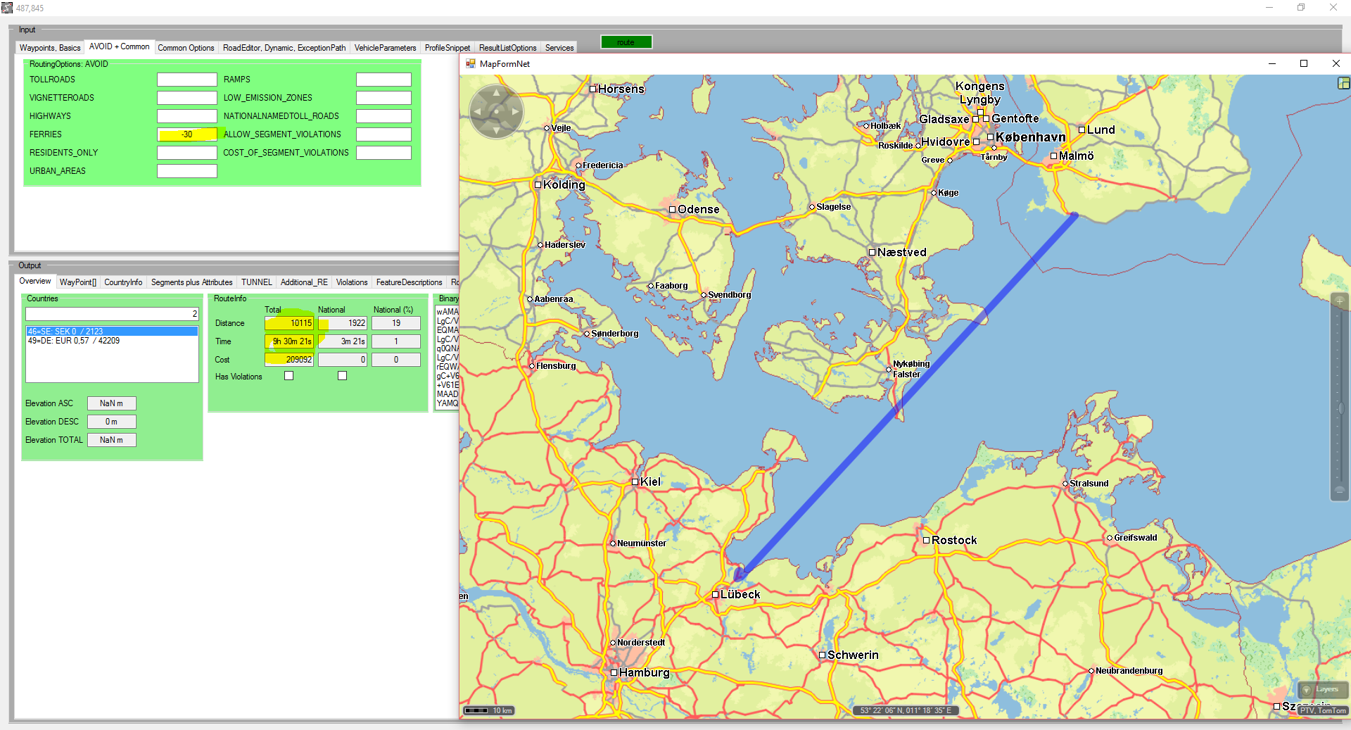

Preferred ferry by 30% (malus=-30)<br />Time: 9h:30m<br />Distance: 10km
Time: 9h:30m
Distance: 10km
Depending on the balance between distance and time (OPTIMIZATION) the ferry is less attractive even with neutral ferry malus (AVOID_FERRIES) as it produces a long period.
If the OPTIMIZATION is focused on "DISTANCE" (values around 0) the neutral ferry malus also returns a FERRY route.

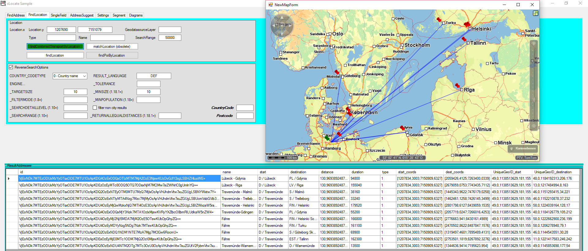

search via xLocate.findCombinedTransports
Check this...
you can also seatch for potential ferries via xLocate ;-) findCombinedTransportByLocation

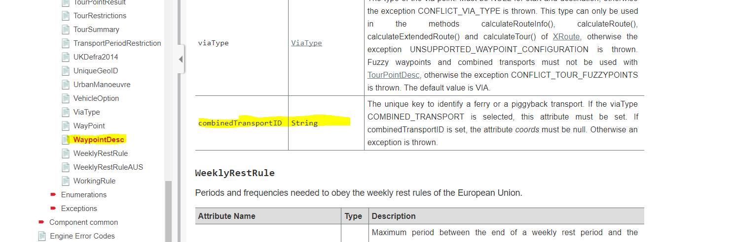

The ID is then a potential property of a waypoint:
WaypointDesc object accepts the ID

I tried to use findCombinedTransportByLocation, it works but I got different results than you. Can you tell me what parameters you used in this method? I tried:
    var location = xLocate.findCombinedTransportByLocation(new findCombinedTransportByLocationRequest
                    ArrayOfResultField_3 = new ResultField[] { },
                    ArrayOfSearchOptionBase_2 = new SearchOption[] { new SearchOption { param = SearchParameter.COUNTRY_CODETYPE, value = "0" },
                     new SearchOption{param=SearchParameter.RESULT_LANGUAGE,value="DEF" },new SearchOption{param=ERouteSearchType.} },
                    CallerContext_4 = new CallerContext
                        wrappedProperties = new[] { new CallerContextProperty { key = "CoordFormat", value = RouteLayerExtensions.SpatialReferenceId } }
                    Location_1 = loc,
Posts: 3085
Re: Ferry from Trelleborg to Travemunde (Lubeck)
I tried this:
<Location_1>
	<coordinate xmlns="http://xlocate.xserver.ptvag.com">
		<point x="1207690" y="7151079" xmlns="http://common.xserver.ptvag.com" />
	</coordinate>
</Location_1>
<ArrayOfSearchOptionBase_2>
	<SearchOptionBase xsi:type="ReverseSearchOption" value="0" param="COUNTRY_CODETYPE" xmlns="http://xlocate.xserver.ptvag.com" />
	<SearchOptionBase xsi:type="ReverseSearchOption" value="10" param="ENGINE_TARGETSIZE" xmlns="http://xlocate.xserver.ptvag.com" />
	<SearchOptionBase xsi:type="ReverseSearchOption" value="DEF" param="RESULT_LANGUAGE" xmlns="http://xlocate.xserver.ptvag.com" />
	<SearchOptionBase xsi:type="ReverseSearchOption" value="10" param="ENGINE_MINSIZE" xmlns="http://xlocate.xserver.ptvag.com" />
</ArrayOfSearchOptionBase_2>
Maybe you are using a different map version?
I used maps.path=C:/PTV-XSERVER/MAPS/PTV_Europe_City_Map_Premium_2018_1H
kris.request.xml
complete request
(3.74 KiB) Downloaded 845 times
kris.response.xml
complete response
(27.09 KiB) Downloaded 836 times

I'm looking for the possibility to add custom combined transport and use it in xRoute calculations. I find this screenshot very interesting which implies that it is possible to add custom combinedTransportId?
Bernd Welter wrote:
Check this...
