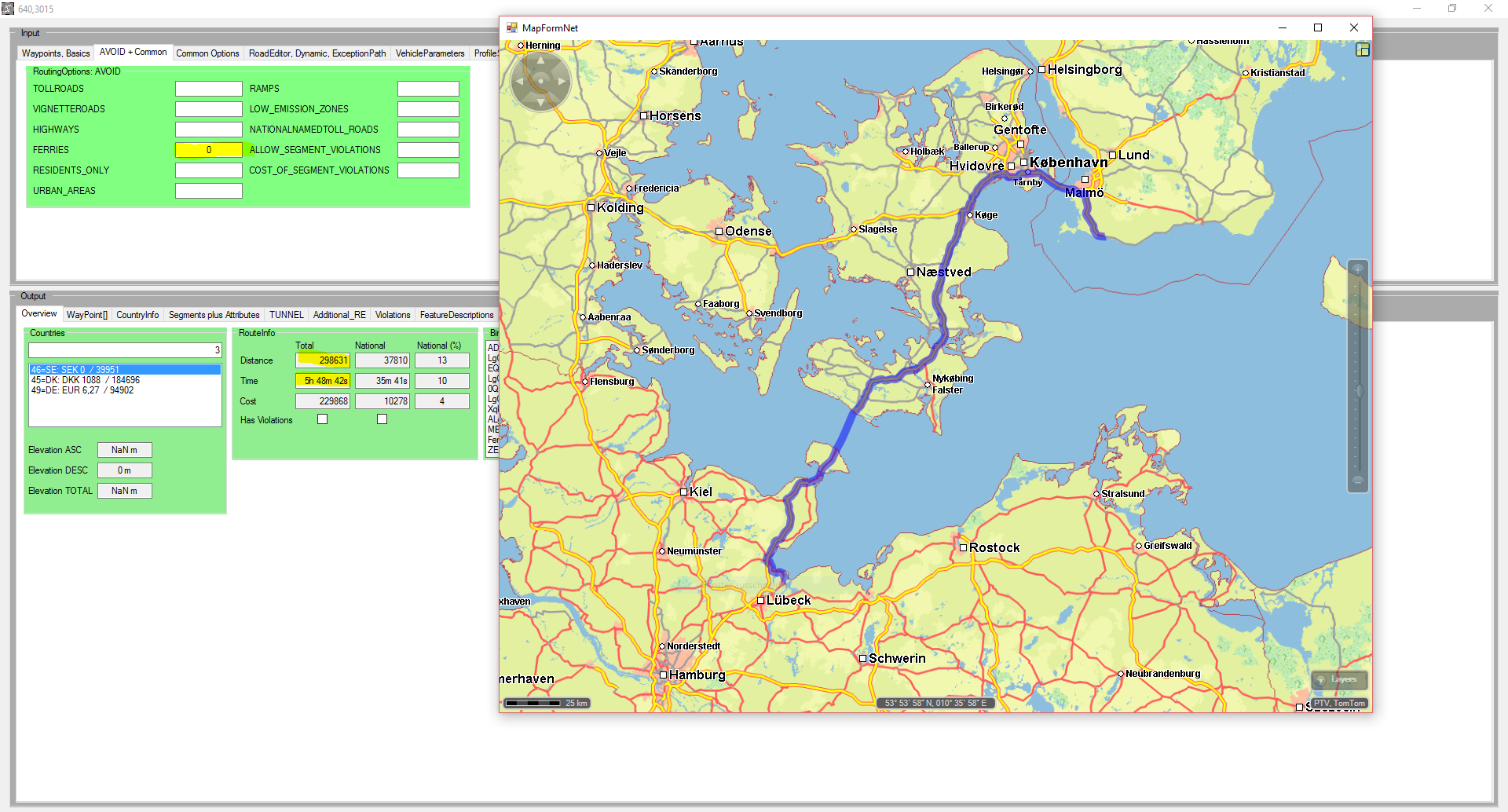

I successfully requested the ferry:
https://xroute-eu-n-test.cloud.ptvgroup ... /ws/XRoute
neutral ferry malus.<br />Time: 5h:48m <br />Distance 299km
Time: 5h:48m
Distance 299km
Preferred ferry by 30% (malus=-30)<br />Time: 9h:30m<br />Distance: 10km
Time: 9h:30m
Distance: 10km
Depending on the balance between distance and time (OPTIMIZATION) the ferry is less attractive even with neutral ferry malus (AVOID_FERRIES) as it produces a long period.
If the OPTIMIZATION is focused on "DISTANCE" (values around 0) the neutral ferry malus also returns a FERRY route.
