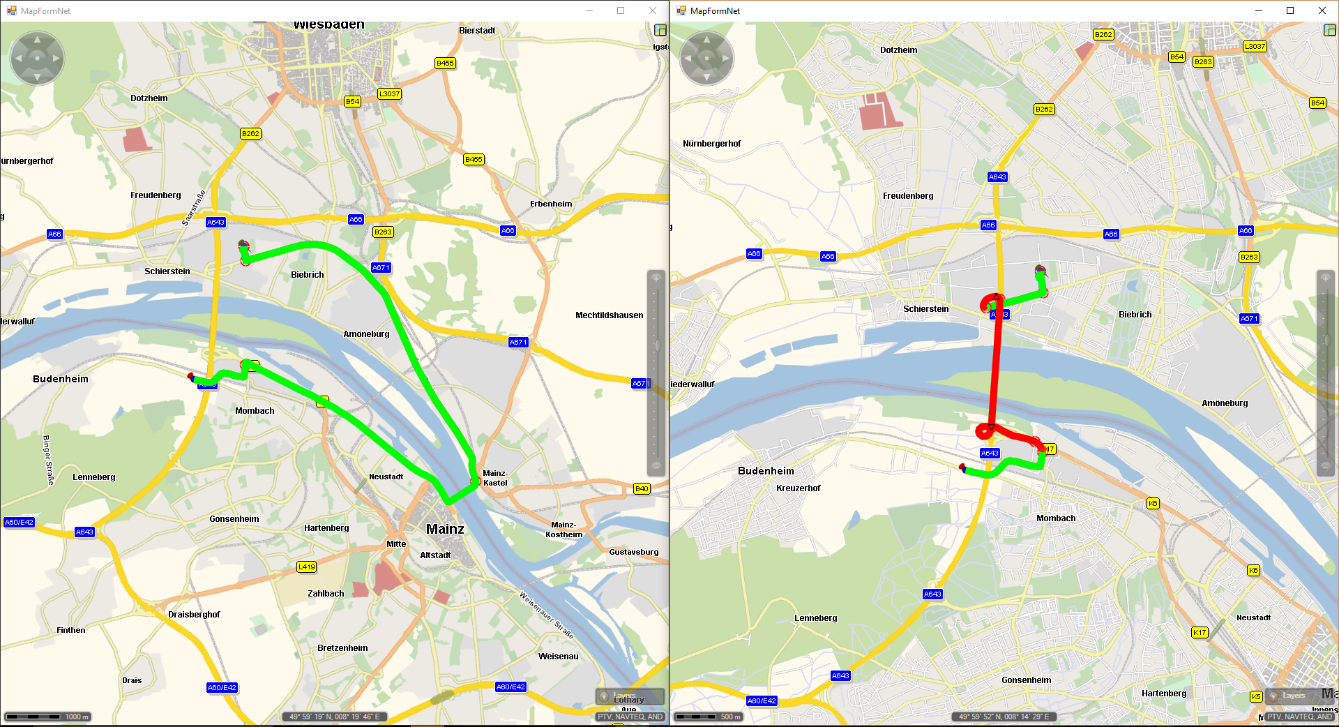

Hello together,
I've been asked how to deal with traffic construction sites that are not part of our map data, e.g. with the famous "Schiersteiner Brücke" https://de.wikipedia.org/wiki/Schiersteiner_Br%C3%BCcke that links Wiesbaden-Schierstein with Mainz-Mombach.
PS: Please feel free to add further objects (official tunnel names, bridges, ...) in replies so we can make them searcheable ;-)
Well, there are several potrential strategies available to deal with such issues. A quick forum posting can't replace the documentation but maybe I can give you some hints and you can evaluate whether one of them fits your current challenge.
  • Approach #1 (quick and dirty): use an ExceptionPath object to malify the bridge and identify it by the street name:
    <ArrayOfExceptionPath_3>
    <ExceptionPath absTimeMalus="0" binaryPathDesc="" extSegments="" relMalus="2501" street="Schiersteiner Br?xmlns="http://xroute.xserver.ptvag.com">
    <wrappedNodes xsi:nil="true" />
    <polyline xsi:nil="true" />
    </ExceptionPath>
    </ArrayOfExceptionPath_3>
    This approach requires you to identify the object within the request which works fine for this bridge because of the street name. It might be more difficult to reference other objects,
    The left map shows the result of the routing based on the ExceptionPath with streetname=&quot;Schiersteiner Brücke&quot; and RelMalus=&quot;2501&quot;: the bridge is avoided and the track takes a large detour.
    The left map shows the result of the routing based on the ExceptionPath with streetname="Schiersteiner Brücke" and RelMalus="2501": the bridge is avoided and the track takes a large detour.

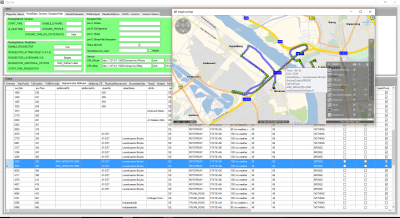

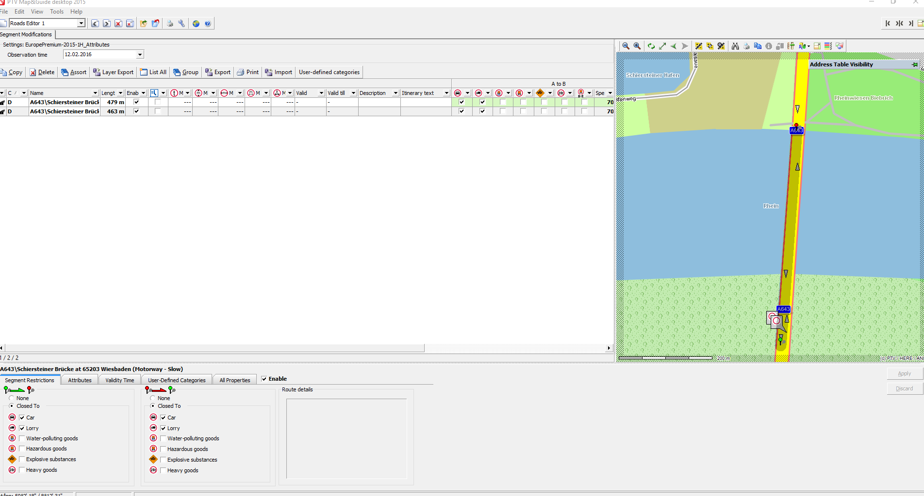

  • Approach #2 (less quick, much more effort): use the RoadEditor of Map&Guide Desktop: block the street in both directions and create a binary truckattributes file which can be used in the xRoute:
    <RoutingOption parameter="ROADEDITOR_LAYERNAME" value="SchiersteinerBr?xmlns="http://xroute.xserver.ptvag.com" />
    <RoutingOption parameter="ENABLE_ROADEDITOR" value="True" xmlns="http://xroute.xserver.ptvag.com" />
    This is how the RoadEditor looks like in Map&amp;Guide Desktop. I blocked the two directions and exported the data into a binary layer file. Afterwards I copied the file into my map folder/RE and referenced it during the routing call.
    This is how the RoadEditor looks like in Map&Guide Desktop. I blocked the two directions and exported the data into a binary layer file. Afterwards I copied the file into my map folder/RE and referenced it during the routing call.
  • For those who have proper access to a direct RoadEditor database you can also use the database approach.
Here are some screenshots... Have fun!

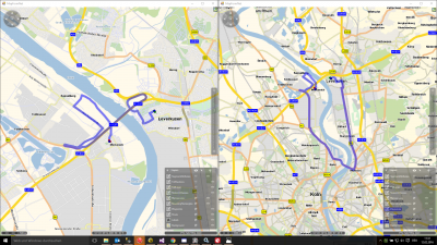

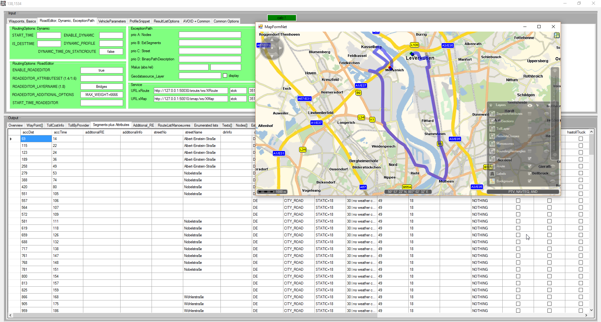

And another Example which works fine with ExceptionPath+StreetName+RelMalus:
  • Leverkusener Brücke
    Leverkusener Brücke

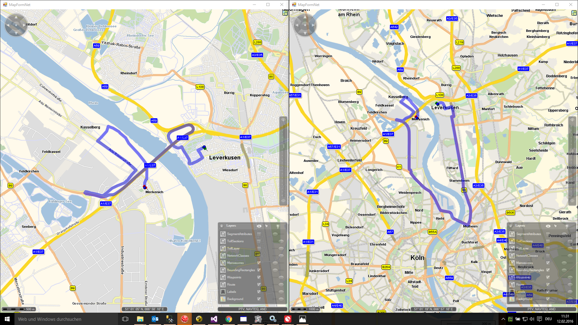

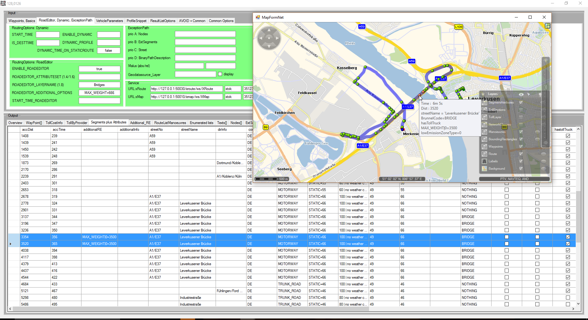

Another important info:
The Leverkusener Brücke is blocked for trucks exceeding MAX_WEIGHT=3500.
So this is a conditional blocking and requires RoadEditor (or you have to decide about which ExceptionPaths you need for the current routing).
RoadEditor attributes MAX_WEIGHT used. This truck weighs 666 kilograms and is therefore allowed to use the bridge.
And this truck weighs 6666kg and exceeds the MAX_WEIGHT so it has to perform a detour.

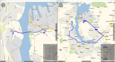

And here we go : another challenge is the so-called WARNOW Tunnel near Rostock.
Some customers want to avoid this tunnel because it raises toll lof type SPECIALCHARGETUNNEL.
https://de.wikipedia.org/wiki/Warnowtunnel
comparison of tracks with and without the tunnel. I used the simple EXCEPTIONPATH approach with streetname and relmalus for this blocking.

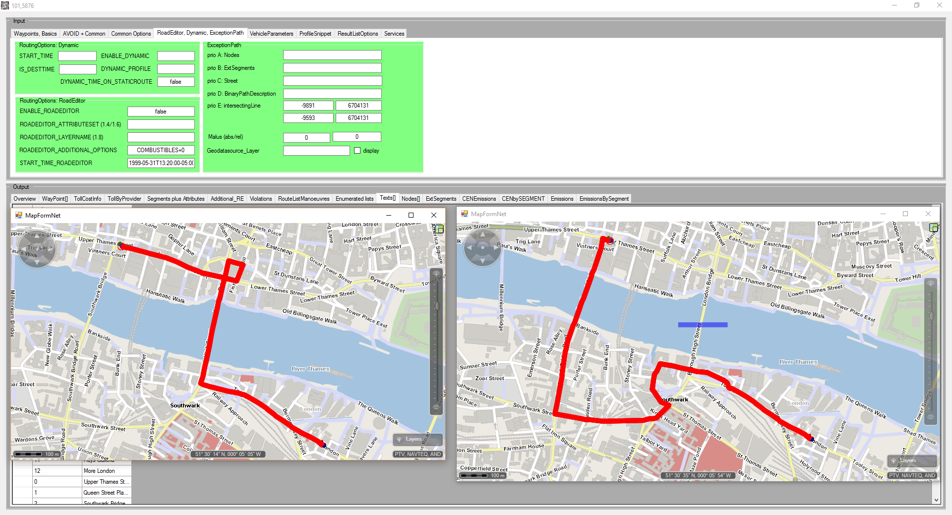

Here is another example: the LONDON BRIDGE
Left map: using the LONDON BRIDGE is possible - there is no INTERSECTING LINE defined.<br />Right map: crossing the bridge is forbidden due to the INTERSCTING LINE with a malus of 2600
