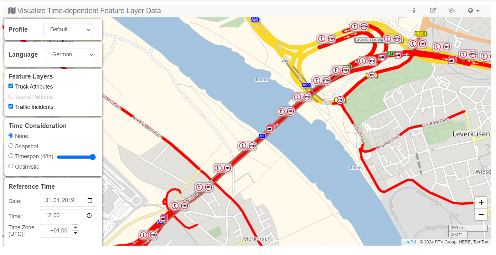

And another Example which works fine with ExceptionPath+StreetName+RelMalus:
  • Leverkusener Brücke
    Leverkusener Brücke

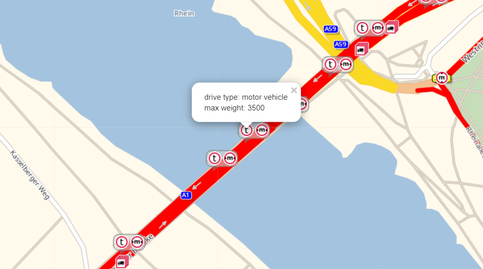

Another important info:
The Leverkusener Brücke is blocked for trucks exceeding MAX_WEIGHT=3500.
So this is a conditional blocking and requires RoadEditor (or you have to decide about which ExceptionPaths you need for the current routing).
RoadEditor attributes MAX_WEIGHT used. This truck weighs 666 kilograms and is therefore allowed to use the bridge.
And this truck weighs 6666kg and exceeds the MAX_WEIGHT so it has to perform a detour.

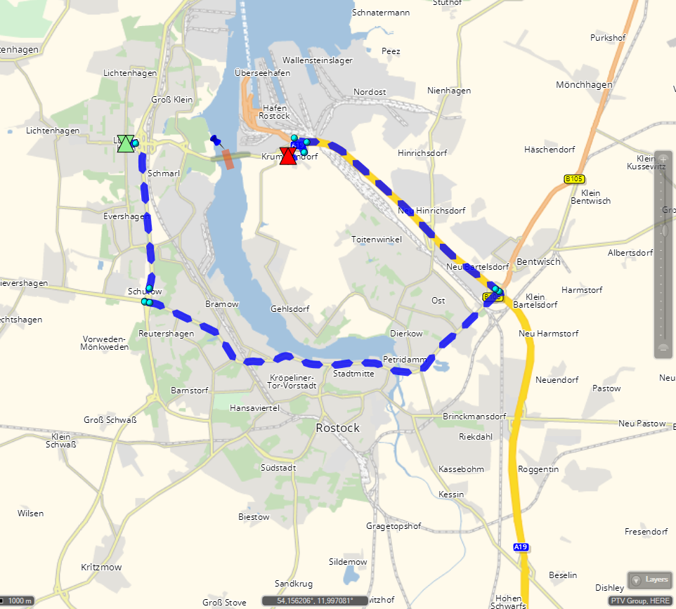

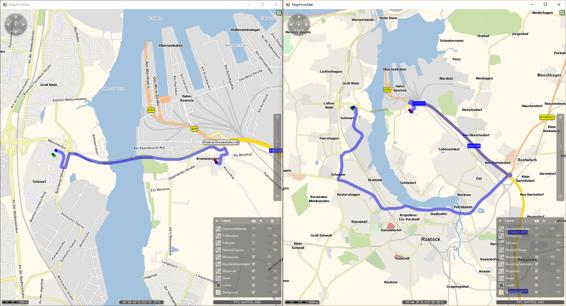

And here we go : another challenge is the so-called WARNOW Tunnel near Rostock.
Some customers want to avoid this tunnel because it raises toll lof type SPECIALCHARGETUNNEL.
https://de.wikipedia.org/wiki/Warnowtunnel
comparison of tracks with and without the tunnel. I used the simple EXCEPTIONPATH approach with streetname and relmalus for this blocking.

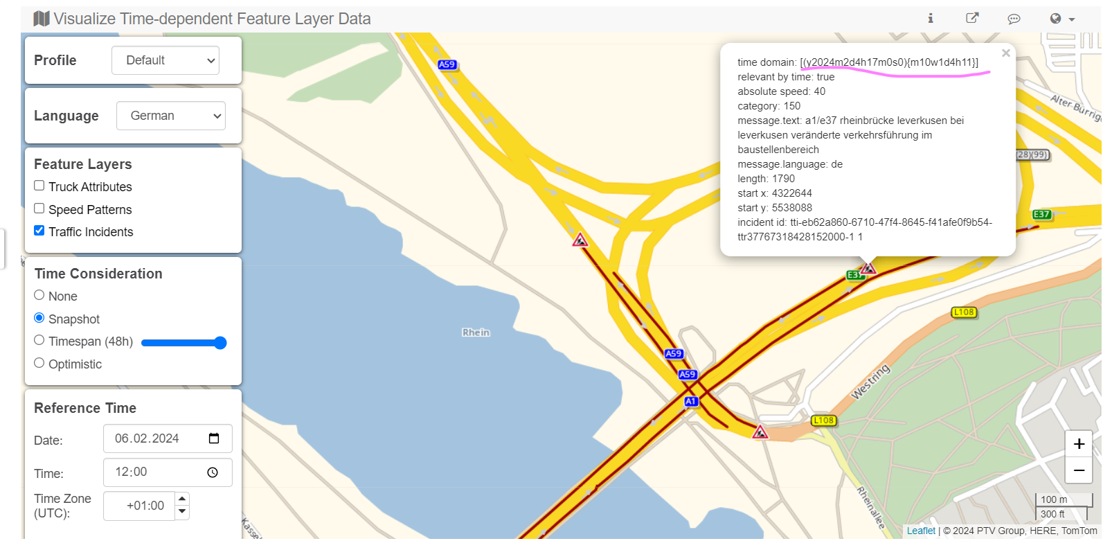

Posts: 3099
Re: Schiersteiner Brücke - how to deal with construction sites?
Short update about the LEVERKUSENER BRÜCKE
It has been reopened 4.2.2024 !
The screenshot below is based on the 2024.1H which is currenty behind XSI2. So in todays LIVE map the bridge is still blocked for
The next map version 2024.2H will reflect the "new situation" and is supposed to be available by the of february 2024 and then installed on XS.
Do not hesitate to get back to me if you have questions!

2024.1H : current &quot;traffic situation&quot; given by TOMTOM HD traffic (event started 4.2.2024 - expected to last 10 months - impact: speed reduced to 40km/h)
2024.1H : current "traffic situation" given by TOMTOM HD traffic (event started 4.2.2024 - expected to last 10 months - impact: speed reduced to 40km/h)

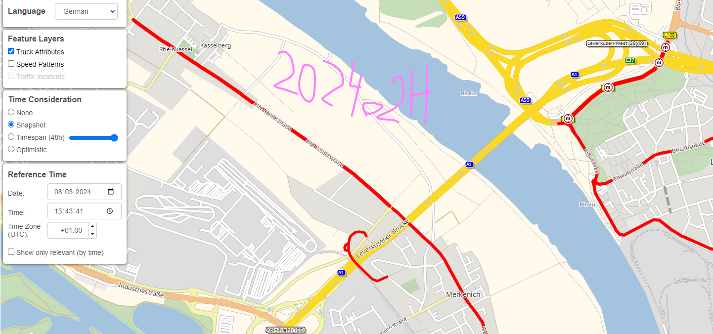

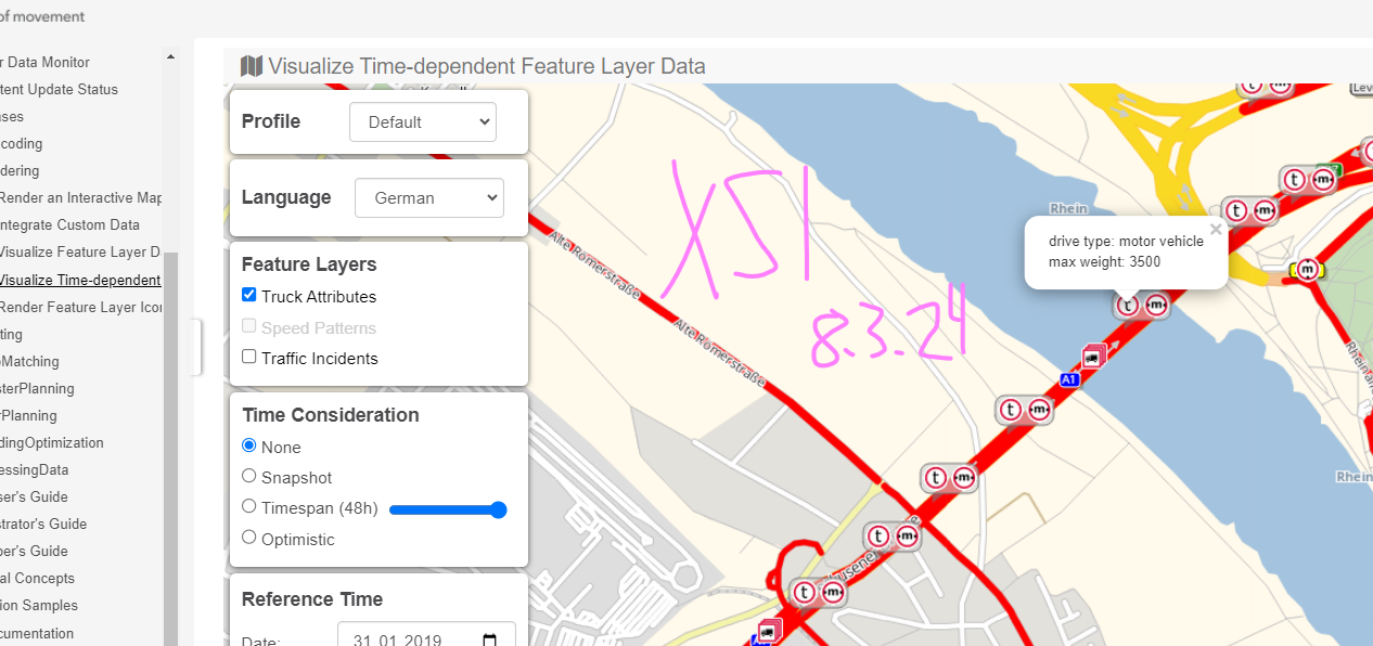

Posts: 3099
Here are some news about the Leverkusener Brücke:
It has been "reopened": https://www.ksta.de/region/leverkusen/a ... nrw-729702
2024.2H map: no critical attributes in the bridge
2024.1H map : the bridge is blocked via PTV TruckAttributes
