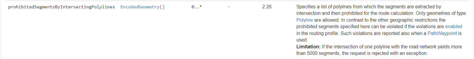

IN v2.26 we will offer an new Geographic Restriction property prohibitedSegmentsByIntersectingPolylines: This will also work in xServer internet... and DIMA...!
- Posts: 3099
Re: xRoute2: Restrict routes through Kosovo (start in Serbia)
HI there,

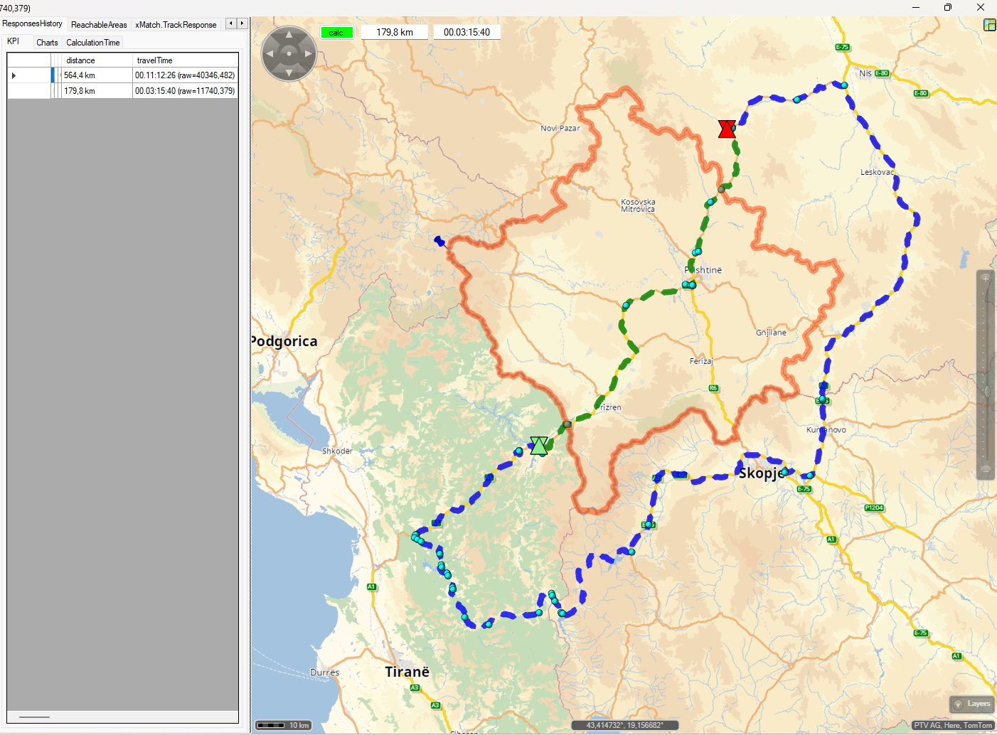

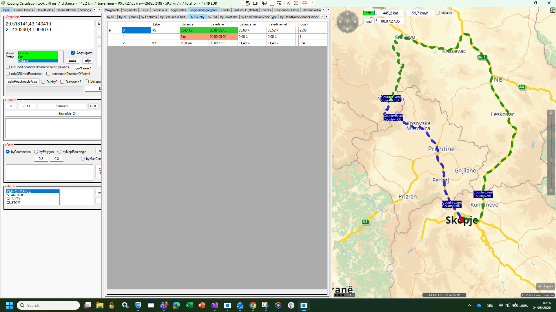

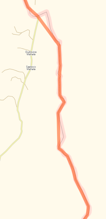

In the meantime I added the com.ptvgroup.xserver.routing.GeographicRestrictions.prohibitedSegmentsByIntersectingPolylines to my testclient. Here's some footage based on the KOSOVO polyline: The sample polyline I gathered was originally based on about 20'000 points which is too much for the API, so I used only every 10th coordinate.
Best regards,If these polylines intersect more than 5000 segments, the request is rejected with an exception.

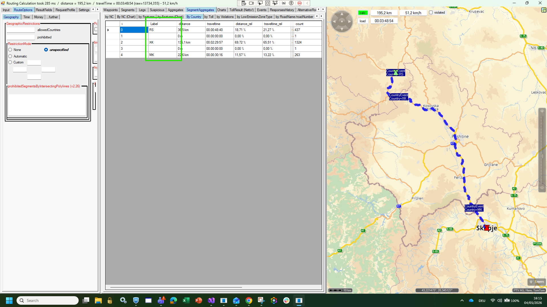

Some news in this context:

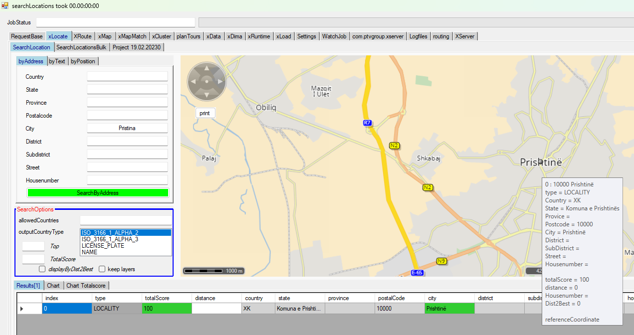

- Starting with then Map 2026.2 HERE the area of the Kosovo is getting the inofficial, technical countrycode "XK"
- Based on this it is then possible to identify trespassing this area and to avoid the region via the well known "prohibitedCountries" feature
- Geocoding is in progress: xLocate2.40 returns the code, but does not yet consider the ""allowedCountries" with the code properly (coming soon)
- 4.5.2026: Already in effect on my local xServer2 - about to come on Developer soon
