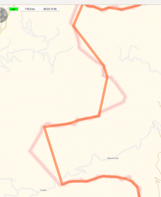

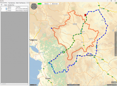

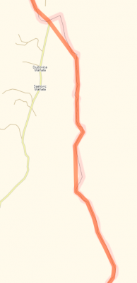

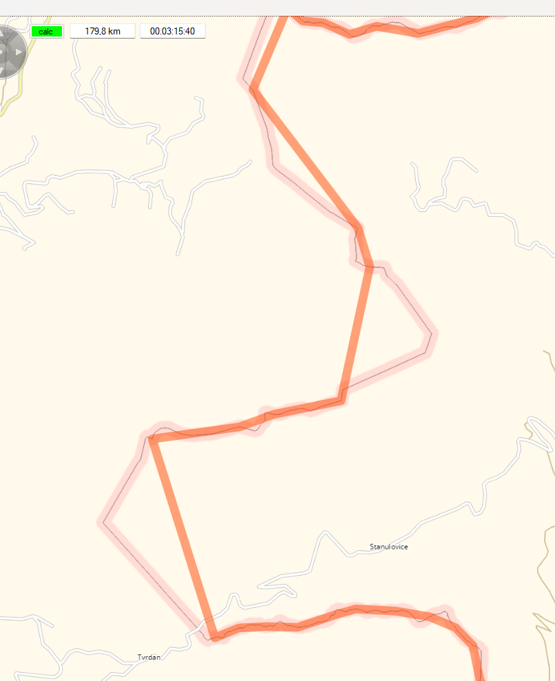

In the meantime I added the com.ptvgroup.xserver.routing.GeographicRestrictions.prohibitedSegmentsByIntersectingPolylines to my testclient. Here's some footage based on the KOSOVO polyline: The sample polyline I gathered was originally based on about 20'000 points which is too much for the API, so I used only every 10th coordinate.
Best regards,If these polylines intersect more than 5000 segments, the request is rejected with an exception.
