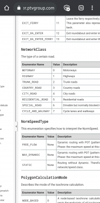

afaik Avoid_Highways refers to NC0 AND NC1.
Residentials is NC5.
I'll cross check this with DEV!
But I think you are on a proper path,
definition of network classes. Taken from xserver 1 documentation
