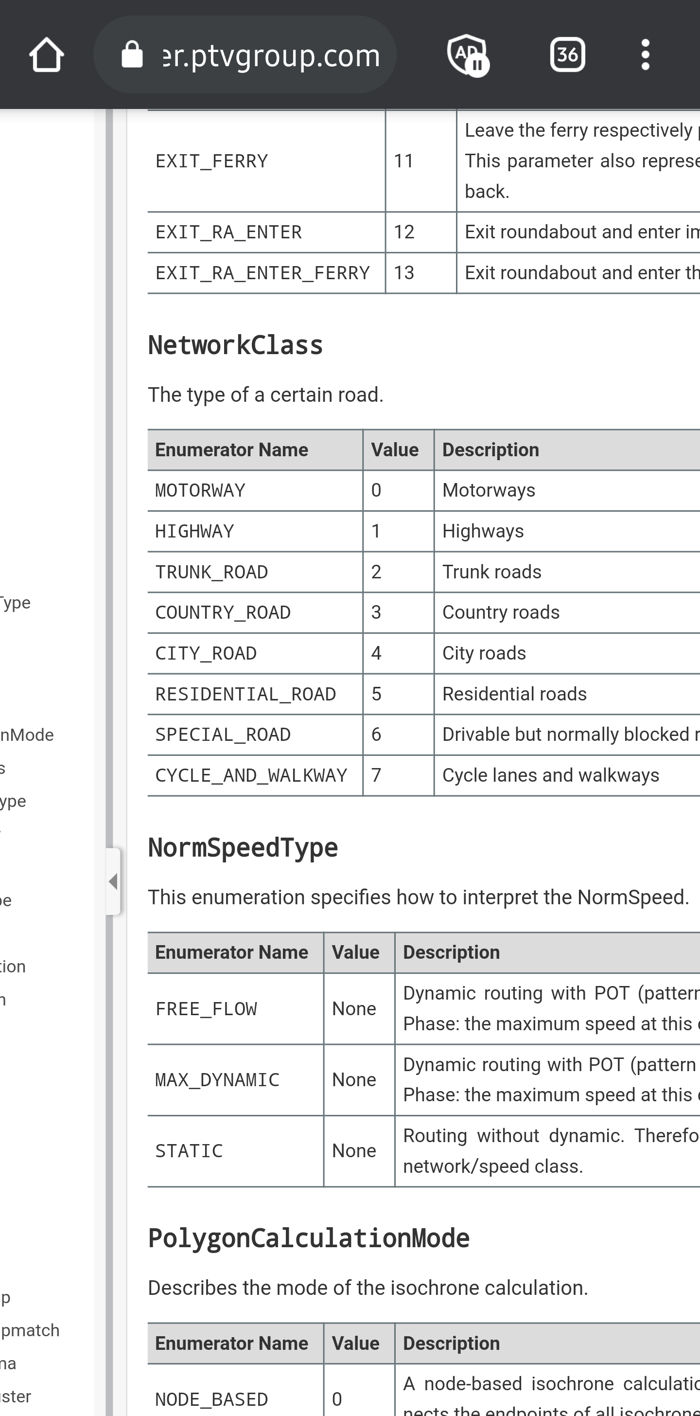

Hi Mr Schuster,
afaik Avoid_Highways refers to NC0 AND NC1.
Residentials is NC5.
I'll cross check this with DEV!
But I think you are on a proper path,
definition of network classes. Taken from xserver 1 documentation
Posts: 318
Re: Routing options to use motorways and ferries
About "IDrivingOptions_5_4_0_0::put_ResidentsOnlyFactor"
That is found at:
Routing / Course / BasicDataRules / SpecialAreas / @residentialMalus (xServer 1 profile)
RequestBase.requestProfile.routingProfile.crourse.apecialAreas.residentsOnlyPenalty (xServer 2 request)
It is not connected to a specific road type (== network class) but to a segment attribute. The attributes indicates that access to the road is only allowed for people who are resident.

For me "course::specialAreas::residentsOnlyPenalty" sounds more reasonable as equivalent for "IDrivingOptions_5_4_0_0::put_ResidentsOnlyFactor". I will try that (as soon as I remember a test case for that).
