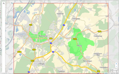

If you want to play with the ALPHA blendings you can update these keys:
[config.background.alphablending]
; Green Zone, green
29=72
; Green Zone, yellow
30=72
; Green Zone, red
31=72
Result:
based on alpha blending = 36
Here's the sample request:
