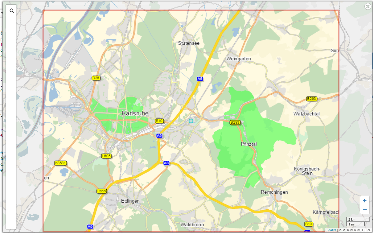

Hello Volker,
copy the two attached files in your /conf/profiles folder and use the "storedProfile=emissionzones". If you want to play with the ALPHA blendings you can update these keys:
#greenzones #emissionzones
Result: Here's the sample request:[config.background.alphablending]
; Green Zone, green
29=72
; Green Zone, yellow
30=72
; Green Zone, red
31=72
"storedProfile" : "emissionzones",
"mapSection": {
"$type": "MapSectionByCenter",
"centerCoordinate": {
"x": 8.4746598928 ,
"y": 49.004840798
"zoom": 10
"imageOptions": {
"width": 800,
"height": 600
}Bernd Welter
