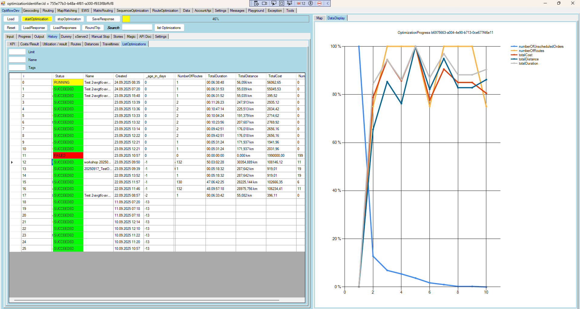

Posts: 3074
Re: List of optimizations running under my token...
SInce version 1.22.0 and 1.23.0 it is now possible to
  • ...look into your existing plannings that are still running or have been processed in the recent days (listOptimizations):
  • ...retrieve requests and results from this cache (getOptimizationRequest / getOptimizationResult)
  • ...monitor the progress of recent plannings (getOptimizationProgress)
