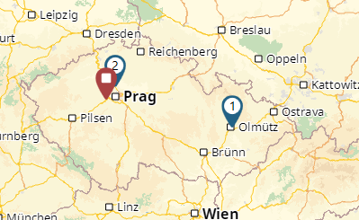

I am looking into optimizing several orders for CZ.
Here is a quick overview of 5 customers, the stop symbol is the 5th customer:
There is a special requirement: Customers which are located near each other (same postal code ares) should be planned together.
In this example: Postal codes starting with 2 is one group, starting with 7 is another group etc.
There should be no tour driving from east to west inside the country. I saw your forum post viewtopic.php?t=1859
I am curious: Is clustering something that can be used together with xTour? Or do you have another idea how to achive this?

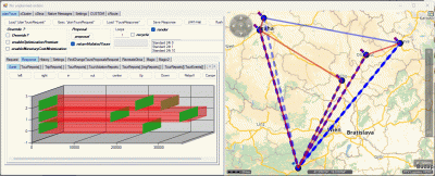

Attached is the request and response that I am currently getting.
The response gives me 3 tours.

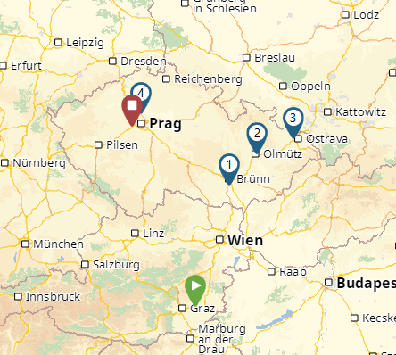

Tour 3 is not ok - driving from east to west - it looks like this:
I already tried setting AvoidIntersections to true but this does not help here.

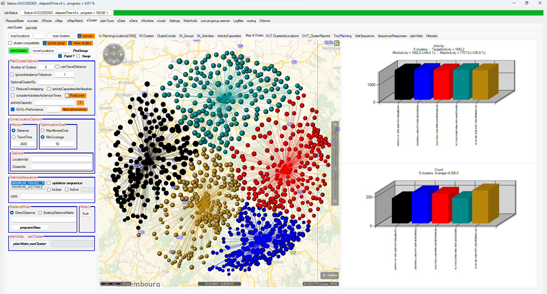

the main purpose of the cluster component is
  • to determine the groups from a strategic level based on "fair distribution within the clusters" (based on huge workloads)
  • and then use the additional group IDs in multiple, distinct operational plannings (e.g. during the next business year). Check this story as an example.
Here's some more thoughts about this:
  • The separation of strategic and operational planning used to be the solution for planning stories with a complexity where the operational components were not able to handle the big scenario. SInce Optiflow is able to handle many thousand orders in a single planning the need for clustering has at least decreased: some customers who were used to perform the 2 step approach (xCluster2+xTour2) are now solving their daily tour plannings with Optiflow in a single step.
  • If you apply a "zip code based" grouping this is understandeable at first - but doesn't reflect the absolute workload in the virtual areas.
From my perspective I'd say we would have to look into your single (small sized) tour optimization call to identify whether we can push the optimization to deliver the desired output.
