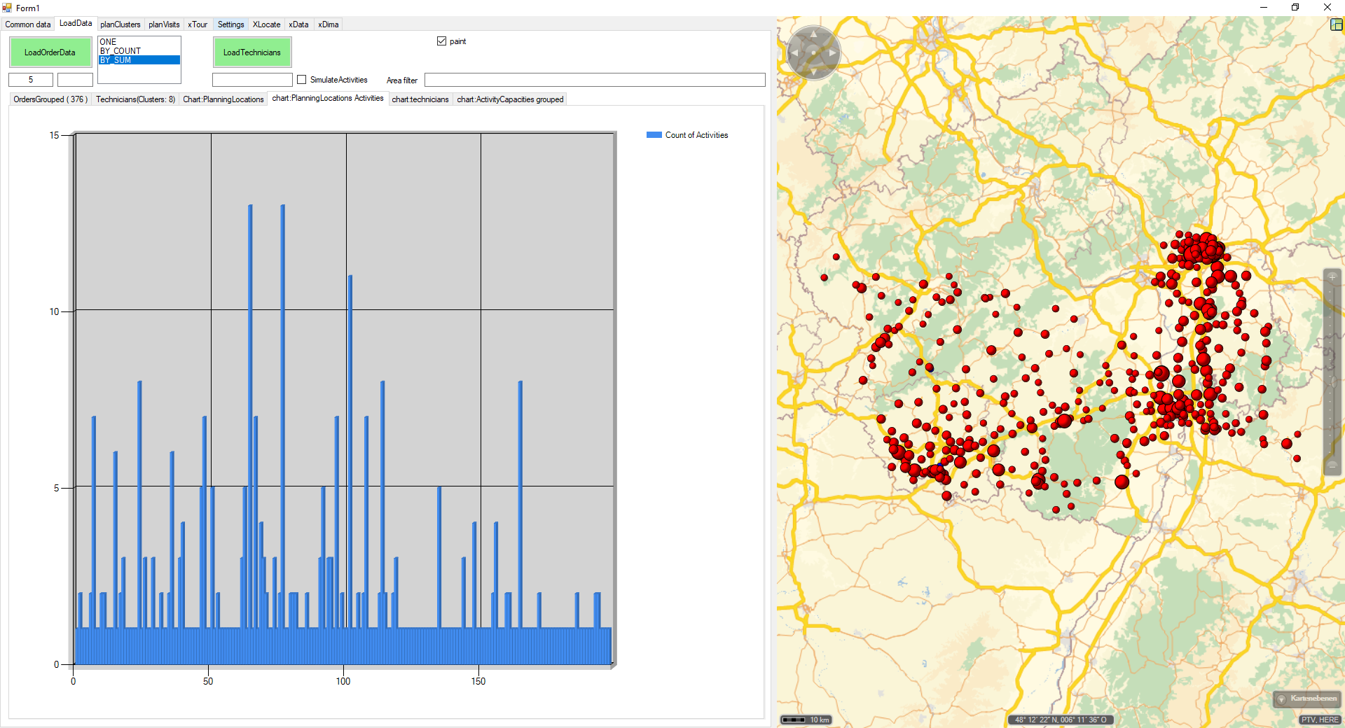

Let's start with a set of georeferenced orders, each one given with (x,y) and additional properties such as service time per visit, post code and more. One specific value is the so called ACTIVITY which can be derived from different other properties. The ACTIVITY is an important value because one of the goals in the following process is to achieve an equal level of activity for each technician as a whole, period or area. Typical sources for the ACTIVITY are:
  • simply the value 1: same number of customers
  • service period within same period of time, e.g. amount of time you spend with an account per year
  • potential revenue : ensure that each sales rep has the opportunity to get the same success
  • category based : often customers are categorized into A/B/C. Just assign each category to a specific score such as (A=10,B=7, C=3)
Several thousand orderes simply clustered by their postcode area. The size of a postcode circle depends on the aggregated service period of all visits in this area. Therefore the size does not reflect the amount of visits itself but another KPI. The chart on the left shows the aggregated activity per postcode areas. Most of the areas in this example have an activity of 1. Only 10 area's activity is betweeen 5 and 10 and just 3 of them exceed 10.

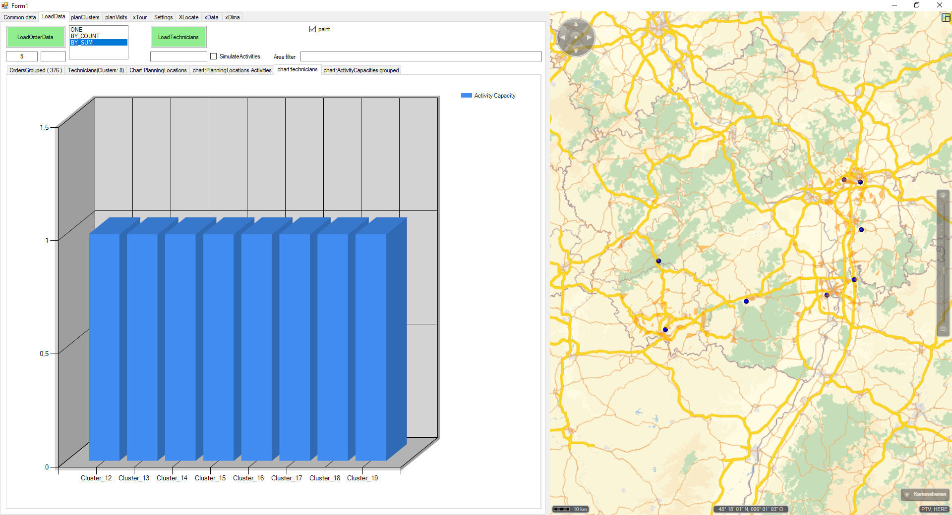

Then we are responsible for a set of technicians with an individual homebase
The eight technicians are located on individual positions and in this scenario one of the targets is to assign an equal aggregated service period to each technician.

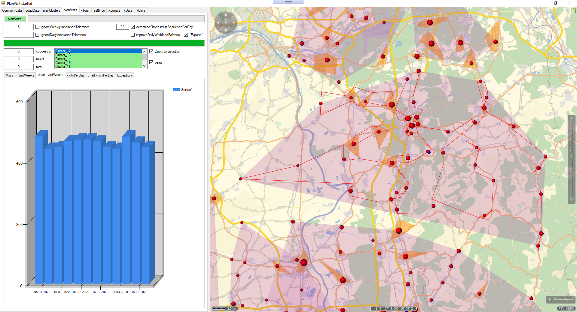

In the third step we focus on the technicians one by one. We use xCluster.planVisits to determine the optimal visit dates for all the visits on the stack of an individual technician. In the next image the original 100% of the visits are resolved so I applied planVisits not only to the roughly 300 postcode areas but to the several thousand indiidual customers. As a simple goodie of xCluster the service can also compute an optimal sequence of the visits within a day. (works fine for a small number of visits).
Each red line in this image shows us the sequence of visits on a specific day. In this example I've chosen a horizon of twelve weeks but this also works fine with longer scopes such as 3 months, 6months or even a whole year.
