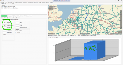

Posts: 2992
Re: New toll tarrifs for Germany (dec2023 / july2024)
Impact of 1.12.2023 on trucks. Did already pay toll. Will have to pay way more toll... (from 126€ to 214€ = plus 70%!)

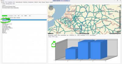

Impact of the new tarrifs for small vehicles (van with total weight about 3.6t) : from zero to hero... changes on 1.7.2024. So far no toll applies - then it will be expensive

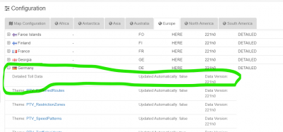

Posts: 2992
Meanwhile the xServer v2.30 is available on XSI TEST
Whether the required toll data is already available in the map can be checked through Configuration.
In the context of 7.9.2023 the data is NOT YET on test...

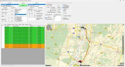

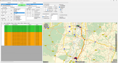

Posts: 2992

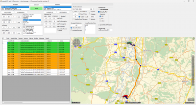

Since last week the provisional toll tarrifs for the German National Toll are published on the PTV xServer Internet TEST 2 environment. The data is not yet on PROD !
Feel free to test and report feedback. See some examples below,
XServer Internet 2 (HERE) TEST Environment: 40t truck
XServer Internet 2 (HERE) TEST Environment: 12t truck
XServer Internet 2 (HERE) TEST Environment: 7.5t truck

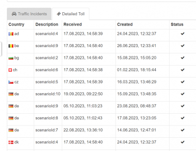

Tschacka!
Check our xserver blog post : Detailed Toll Forecast Germany is online for on premise installations with the 2023.2H map ...
your local CUS will download the scenarios:
http://127.0.0.1:50000/dashboard/Default.htm#Administration/ContentUpdateStatus.htm#detailedToll
Check your local management console for updates.

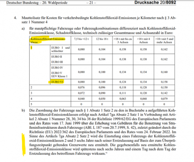

Unfortunately Joost is wrong: EURO_6 is not mapped to "CO2-class 2"!
In xServer1 (based on so-called DF5 data format) we are not able to handle the CO2 emission classes.
Therefore we decided to map all prices in DF5 to the "CO2-class 1” in xServer1.
And there are prices for EURO_6 within "CO2-class 1”.
This info is also available through this article from the German Bundestag : Draft (check page 21)
Currently the emission classes 2-4 are only valid for EURO 6 or higher.
But that does not mean that theres no such thing as a “EURO_6 / CO2-class 1”.
The "CO2-class 5" applies for “vehicles without emissions”, e.g. EV or Hybrid (combined electric and hydrogen engine)
