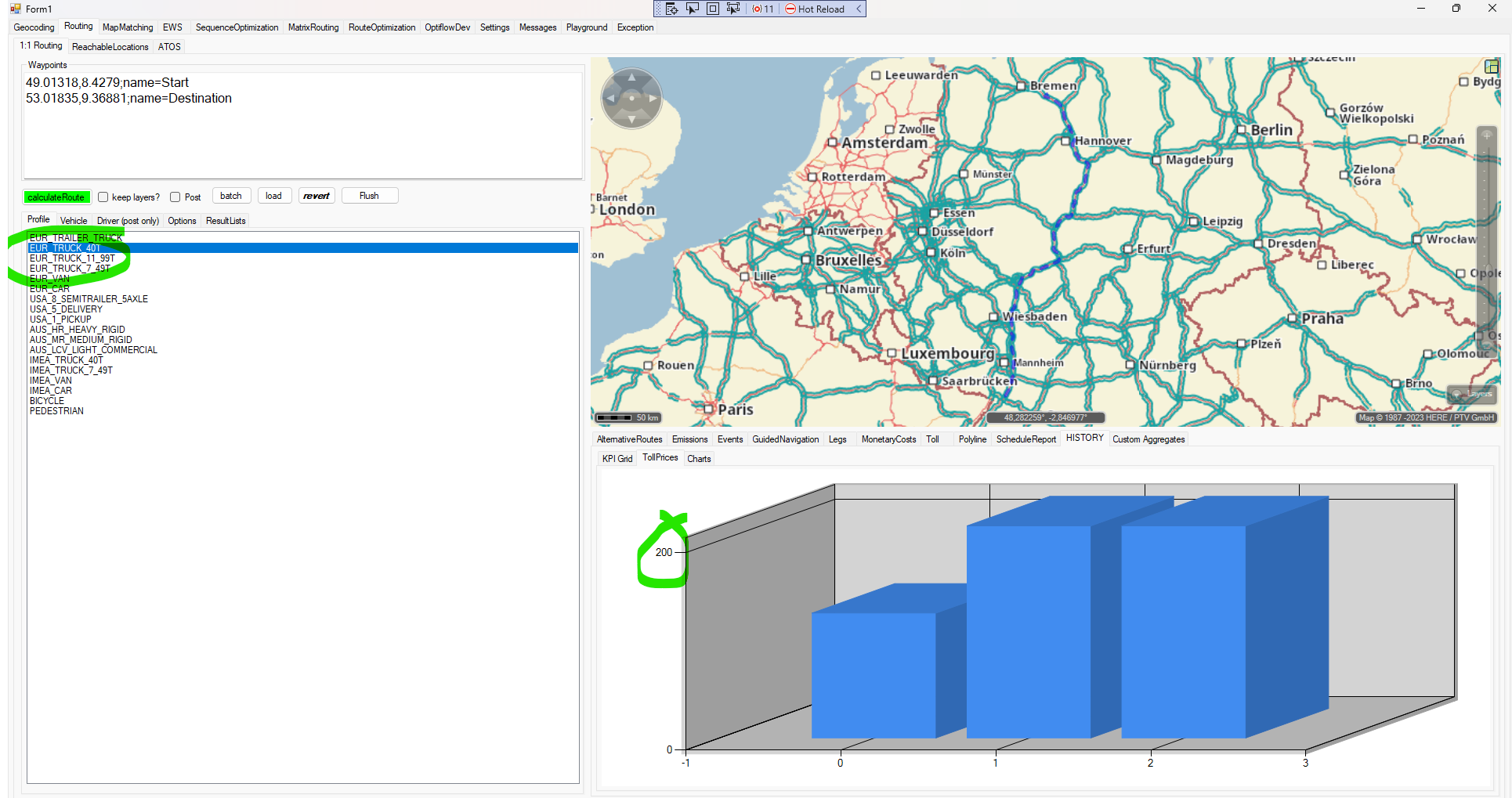

Impact of 1.12.2023 on trucks. Did already pay toll. Will have to pay way more toll... (from 126€ to 214€ = plus 70%!)
Impact of the new tarrifs for small vehicles (van with total weight about 3.6t) : from zero to hero... changes on 1.7.2024. So far no toll applies - then it will be expensive

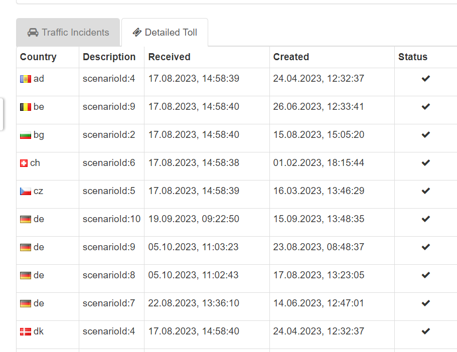

Meanwhile the xServer v2.30 is available on XSI TEST
Whether the required toll data is already available in the map can be checked through Configuration.
In the context of 7.9.2023 the data is NOT YET on test...

Some short update from Technical Product Manager regarding this topic.
There is a new detailed toll update available for Germany.
The layers are activated on Content Update Service (CUS) on September 19th, 2023.
Please Note: The layers are only referenced to World City Map 2023.2H and can only be used with this map.
Content information: Electric Vehicles (free of charge) were added.
  • The statement refers to "detailed toll" which is a xServer2 feature and not available through xServer1.
  • This update does NOT refer to the forecast data "German National Toll" so many of you are waiting for! The content reflects the "free of charge" tarifs for the current toll scenarios!
  • Right now (19.9.2023 / 10:45 CEST) the data is not yet replicated into PTV xerver2 INTERNET

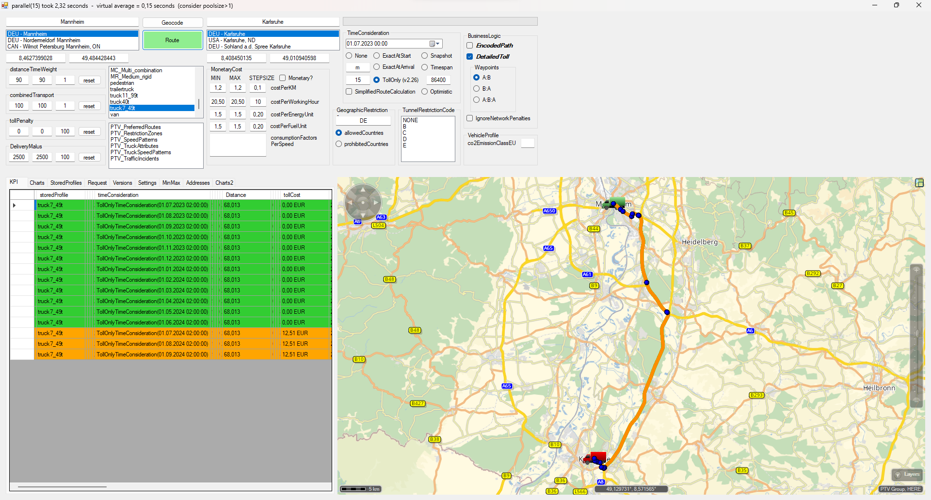

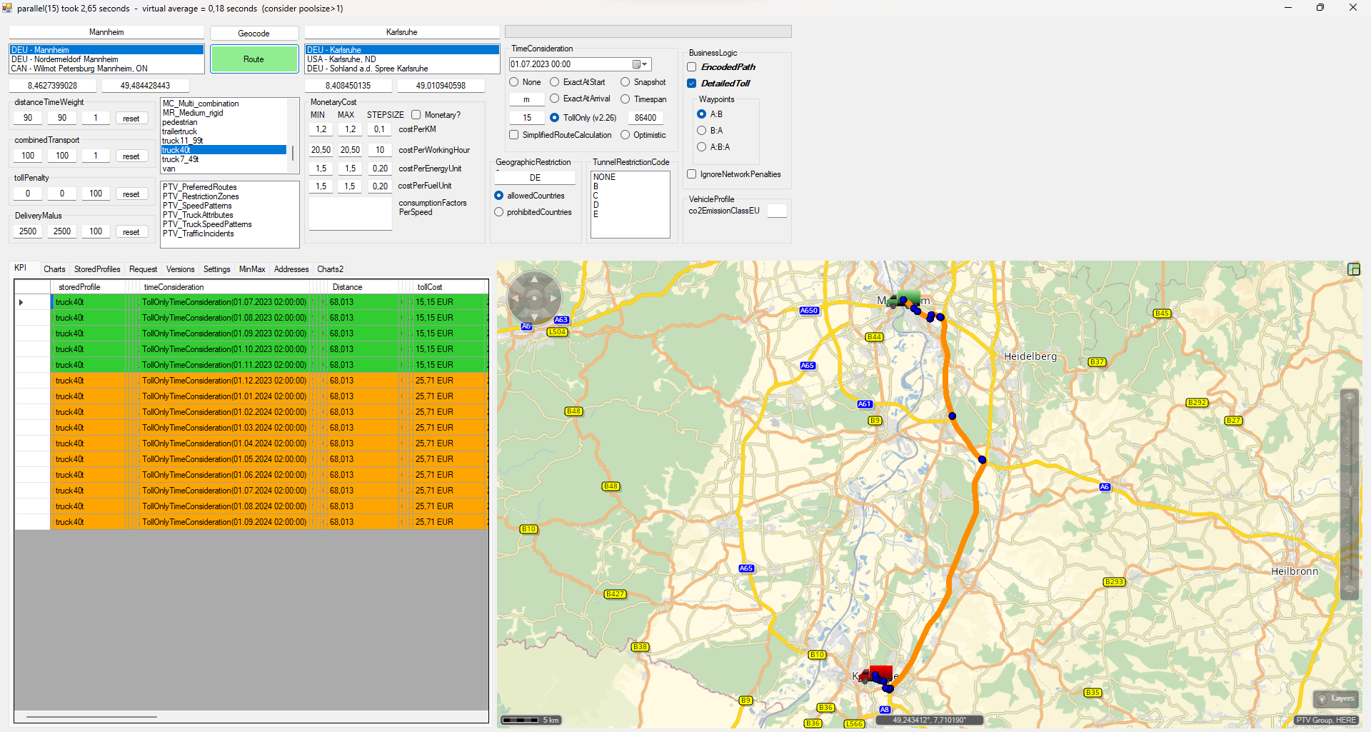

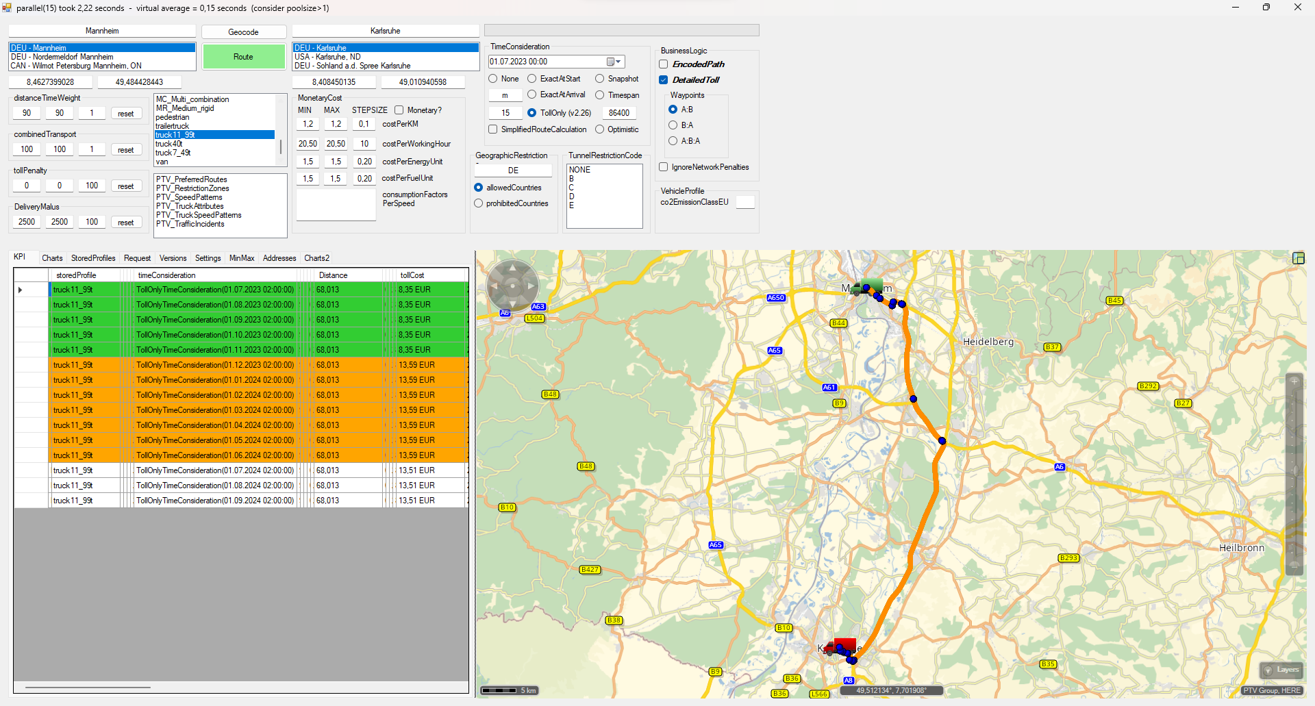

Since last week the provisional toll tarrifs for the German National Toll are published on the PTV xServer Internet TEST 2 environment. The data is not yet on PROD !
Feel free to test and report feedback. See some examples below,
XServer Internet 2 (HERE) TEST Environment: 40t truck
XServer Internet 2 (HERE) TEST Environment: 12t truck

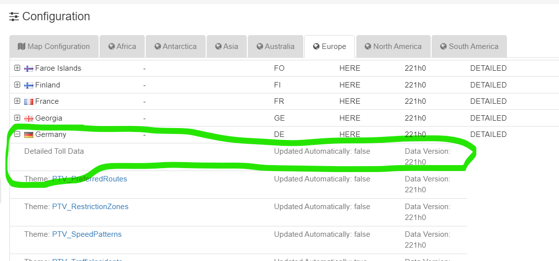

I calculated some routes in december with xServer Internet and the toll results look good so far.
But.. Is there any update planned before december?
The "co2EmissionClassEU" field is currently experimental.
I would like to avoid connecting the experimental API to a production system.
Thanks.

Here's a quick status update:
  • Our data department is preparing the new toll scenarios for German Detailed toll. If everything works according to the plan then the new scenario files for the 2024.1H map will be available on Nov. 27.
  • But please consider the process: the underlying data has to find it's way into the Layer Delivery Server (LDS) and from there via CUS (Content Update Service) into the xServer / PTV Developer.
  • Right now (14.11.2023 / 15:28) the xServer internet 2 hosts:
So this means: we try to be as quick as possible... but we can't guarantee the road map.
