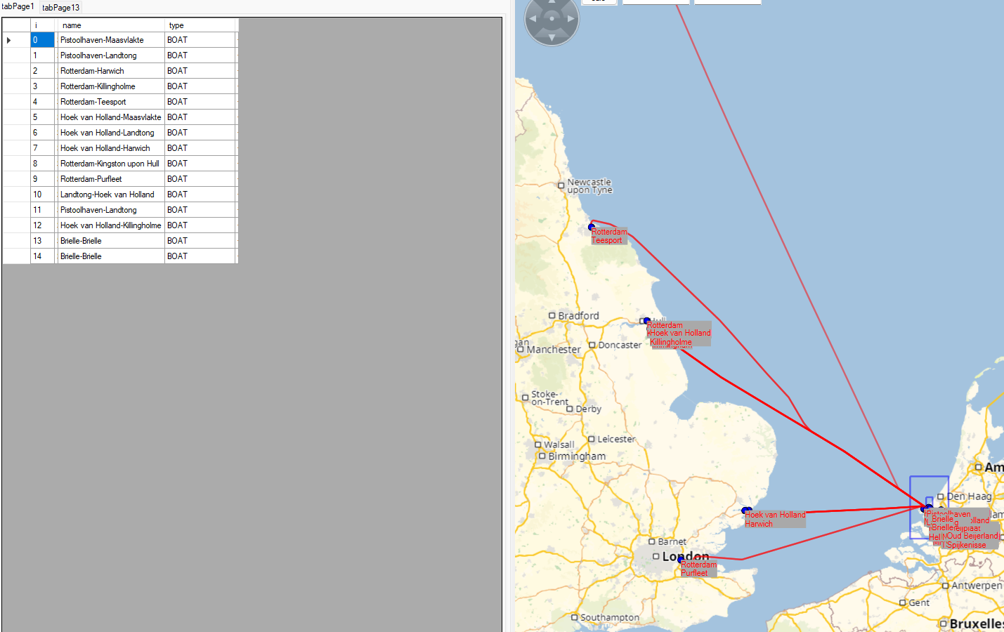

Re: Routing with ferries
Here's just one more screenshot from my sample application.
It demonstrated the potential outpout of the "ferry search dialog".
- Attachments
- Posts: 3050
Another example requested by a partner:
- from Hook van Holland
- to Killingholme
