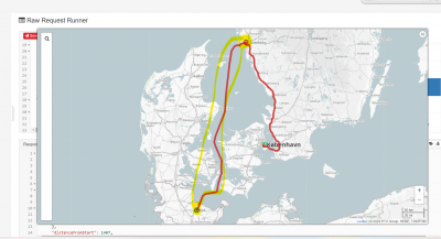

sounds like you need the following information:
  • We support a so-called com.ptvgroup.xserver.xroute.CombinedTransportViaWaypoint, which is a dedicated ferry connection from one unique start port to a unique destination port. To define such a waypoint you need to provide the combinedTransportId
  • To gather the combinedTransportId you can use the com.ptvgroup.xserver.xdata.SegmentsRequest which enables you to search for such an ID:
  • The search could be based on various approaches:
  • For the SegmentOptions you need to search for SegmentType.COMBINED_TRANSPORT
  • This is a nearest search in the region of Kiel
    • Code: Select all
        "$type": "SegmentsByCoordinateRequest",
        "segmentsOptions": {
          "includedSegmentTypes":["COMBINED_TRANSPORT"]
        "resultFields": {
          "polyline": true,
          "descriptors": true
        "coordinate": {
          "x": 10.132240358,
          "y": 54.323249814
    • Response
        "$type": "SegmentsResponse",
        "segments": [
            "type": "COMBINED_TRANSPORT",
            "polyline": {
              "plain": {
                "$type": "Polyline",
                "polyline": [
                    "x": 10.140115155,
                    "y": 54.319672521
                    "x": 11.914234093,
                    "y": 57.695938264
            "id": "SEGM00028f61c441v6PFAeoSAeY72m4SlWvidQL9G/oVRsIYzlEa0BvMbh6Za+J5RbckwFUGxgSYGQj2LM1uKKxo8nVatAr+AkfQAI0YCPZlh1M0zS3lRTnjHNtnG6NmhjIe2C7wNUTtf/s="
  • And here comes the routring request
        "waypoints": [
            "$type": "OnRoadWaypoint",
            "location": {
            "coordinate": {
              "x": 10.132240358,
              "y": 54.323249814
            "considerAlternativeNearByRoads": false
          "$type": "CombinedTransportViaWaypoint",
          "combinedTransportId": "SEGM00028f61c441v6PFAeoSAeY72m4SlWvidQL9G/oVRsIYzlEa0BvMbh6Za+J5RbckwFUGxgSYGQj2LM1uKKxo8nVatAr+AkfQAI0YCPZlh1M0zS3lRTnjHNtnG6NmhjIe2C7wNUTtf/s="
          "location": {
            "coordinate": {
              "x": 12.567560214,
              "y": 55.67567061
      "resultFields": {
        "polyline": true
:idea: Keep this in mind:
  • SegmentIDs can change from map to map version!

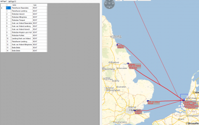

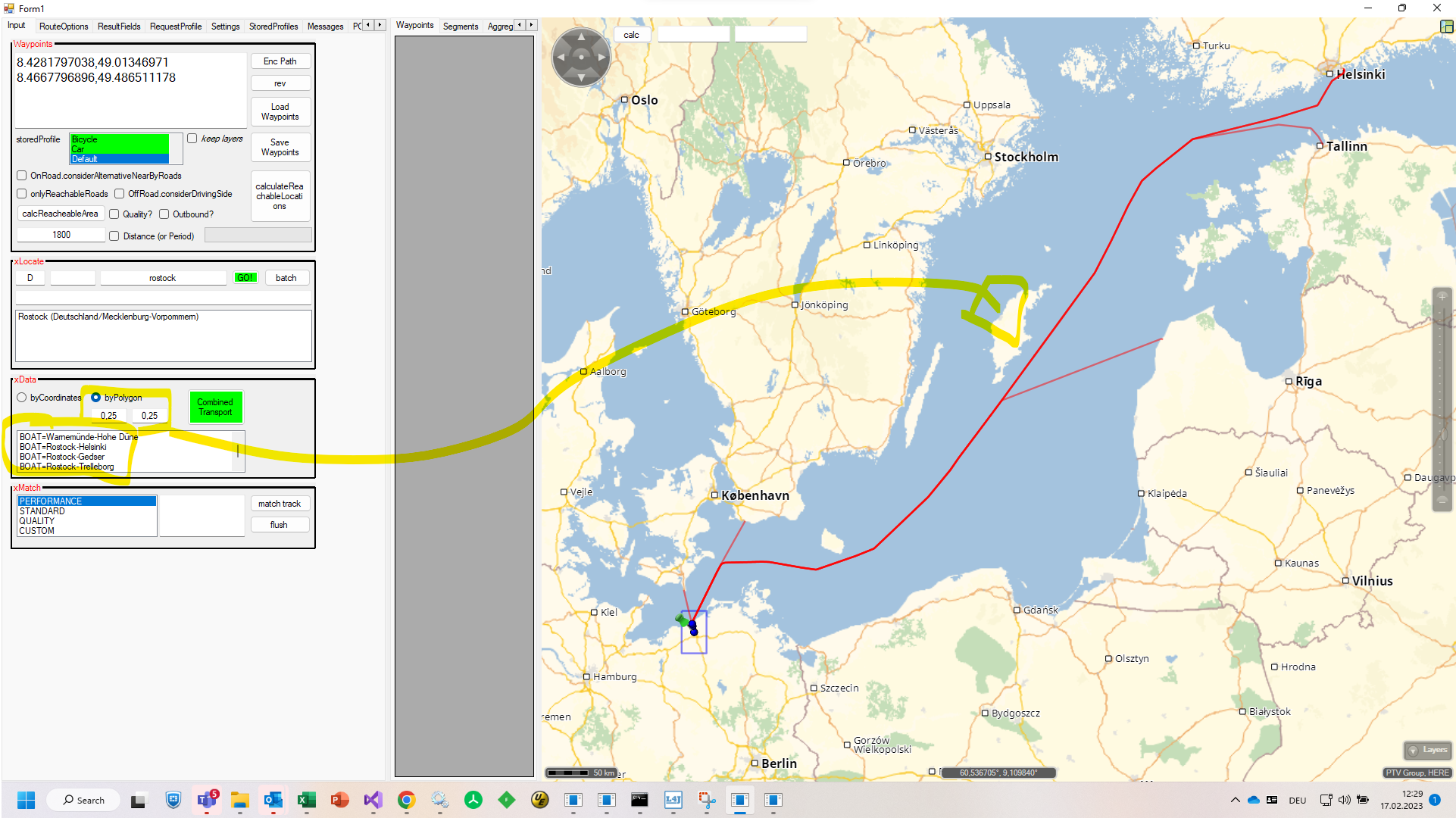

Here's just one more screenshot from my sample application.
It demonstrated the potential outpout of the "ferry search dialog".
Rectangle based search... returns all ferries that depart from a coordinate within the rectangle...

Another example requested by a partner:
  • from Hook van Holland
  • to Killingholme
