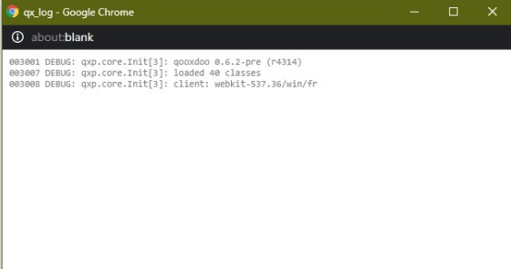

i.kobeissy
- Posts: 24
- Joined: Wed Jan 31, 2018 1:15 pm
Re: AjaxMaps debug Popup
Hello Andreas,
The popup contains the following lines
and here's a screenshot of it
000750 DEBUG: qxp.core.Init[3]: qooxdoo 0.6.2-pre (r4314)
000771 DEBUG: qxp.core.Init[3]: loaded 40 classes
000773 DEBUG: qxp.core.Init[3]: client: webkit-537.36/win/en

This looks like a symptom of another problem. Usually, this is what happens:
1) Some basic infrastructure is set up, including logging (default log level is "debug").
2) The actual map code is loaded, which sets the log level higher.
3) In the onload event, some debug logging is performed (what you see in the popup), but it should be suppressed because of step 2.
So I think the actual problem is some error in step 2. Could you take a look at the JavaScript console to see which errors are printed there when the popup appears?

thanks for your answer, in fact you are right I found that we have errors in the console when the popup is shows
so I will try to solve this issue inside our application
Thank you
Uncaught TypeError: vRequest is null
Uncaught ReferenceError: qxp is not defined
