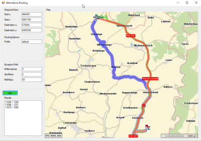

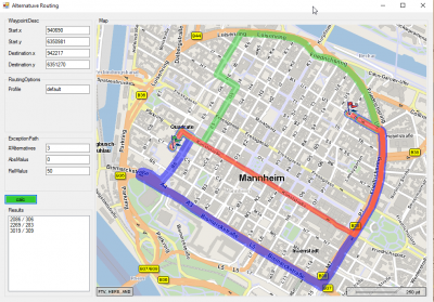

Here are some example screenshots:
urban example
urban example
regional example
regional example
So quite often especially start and final part of a route do not change that much.

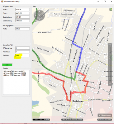

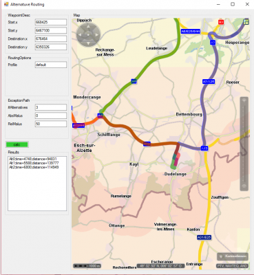

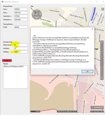

Now setting the ALTERNATIVE ROUTE MALUS means that all the succeeding alternatives will "malify" the segments used in previous ALTERNATIVES. I attached some screenshots, maybe they can help you to understand the approaches,
MALUS = 25, small impact, some initial parts of the alternatives share segments
MALUS = 2500, forces the (n+1) alternative to leave the (0),(1), ..(n) paths. so almost NO overlapping but possible (e.g. green + orange)

MALUS = 2501, segments of a previous call are forbidden which could cause an error due to "no valid path found".
