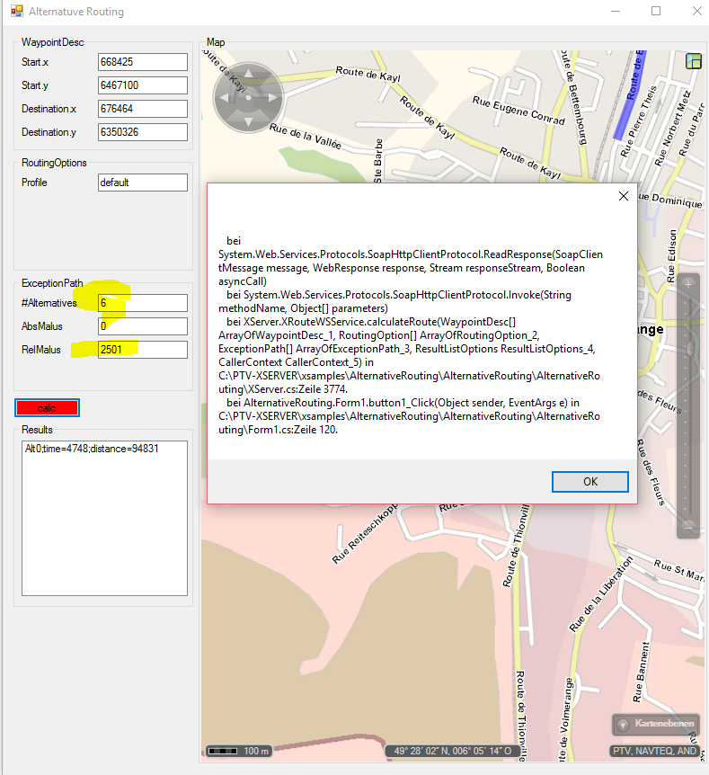

Hi, I've tryed to use a similar method, but I do not like the given results becouse if I assign a malus to a route the system creates a completely different alternative without taking into account that a better choice could be have a part of route in common.Bernd Welter wrote:Hello Vladimir,
basically the computation of alternative routes is based on the following principles:
- in a first step a regular route is calculated, let's call it the VERSION_0.
Route route = svcRoute.calculateRoute(arrWPD, arrRoutingOptions, null, resultListOptions, callerContext);- The output of the call is a route object including a so-called binaryPathDescription.
- Based on the binaryPath you create an ExceptionPath together with a malus that suits your requirements, e.g. 500 if you want to avoid each VERSION_0 segment with a malus of 500%.
- in a second call you use the same routing parametrization (profile/snippet encapsulated in the CallerCOntext, routing options as explicit parameters if necessary) but you add the ExceptionPath as an additional input information.
As you can see in the image xroute gives me a route totally different from the first one. Maybe I've to change the relMalus value but I'm not able to understand the meaning of the different values. Change the relMalus value from 2501 to 2000 doesn't make any difference.
Thank you

Re: Alternative routes together on one map
Thank you very much. With your help my routes are improving.Bernd Welter wrote:Routing means (in rough terms):
determine the sequence of segments that successfully connects waypoint A(x0,y0) to waypoint B(x1,y1) and produces the minimum aggregated "cost".
The costs of a single segment are influenced by various factors, e.g.Now setting the ALTERNATIVE ROUTE MALUS means that all the succeeding alternatives will "malify" the segments used in previous ALTERNATIVES. I attached some screenshots, maybe they can help you to understand the approaches, If not let me know!
