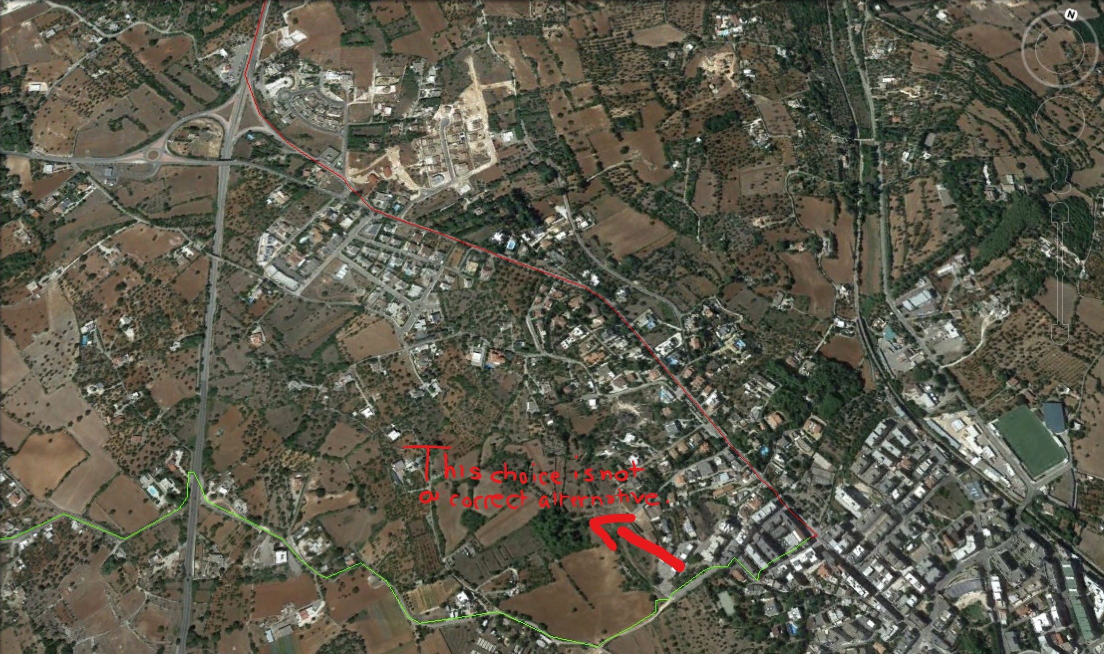

Hi, I've tryed to use a similar method, but I do not like the given results becouse if I assign a malus to a route the system creates a completely different alternative without taking into account that a better choice could be have a part of route in common.
As you can see in the image xroute gives me a route totally different from the first one.
Maybe I've to change the relMalus value but I'm not able to understand the meaning of the different values. Change the relMalus value from 2501 to 2000 doesn't make any difference.

Posts: 3050
Re: Alternative routes together on one map
Routing means (in rough terms):
determine the sequence of segments that successfully connects waypoint A(x0,y0) to waypoint B(x1,y1) and produces the minimum aggregated "cost".
The costs of a single segment are influenced by various factors, e.g.
  • length of a segment
  • driving time (derived by network class via speed values)
  • percentage malus due to road category (AVOID_TOLLROADS, AVOID_...)
  • other malus values (e.g. based on ExceptionPath)
Now setting the ALTERNATIVE ROUTE MALUS means that all the succeeding alternatives will "malify" the segments used in previous ALTERNATIVES. I attached some screenshots, maybe they can help you to understand the approaches,
MALUS = 25, small impact, some initial parts of the alternatives share segments
MALUS = 2500, forces the (n+1) alternative to leave the (0),(1), ..(n) paths. so almost NO overlapping but possible (e.g. green + orange)
MALUS = 2501, segments of a previous call are forbidden which could cause an error due to "no valid path found".
If not let me know!
Regards Bernd
