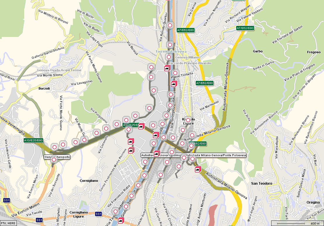

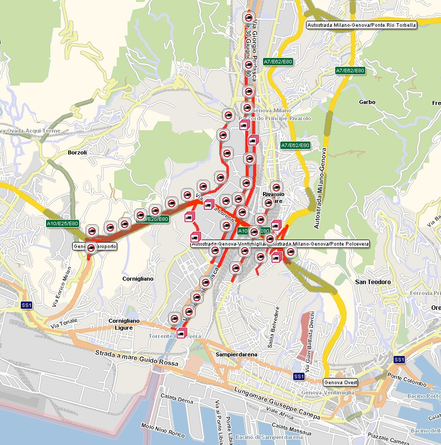

as we all know the Ponte Morandi (=Morandi Bridge = Morandi Brücke) in Genovese (Genova / Genua) collapsed in August 2018. Due to the incident several roads cannot be used and some players asked us whether we can handle this topic and it's derived consequences with xRoute and xMap server.
  • short term (2018.1/2018.2 maps): Our data department produced a special Feature Layer that contains several blockings of the affected streets.
  • mid term (2019.1 maps): The next map versions will simply block the bridge itself (not the underlying streets) via map data (instead of FeatureLayer). Schedules: 2019.1H=end of october 2018, 2019.1T=end of november 2018.
  • Important to know: The special feature layer files do not replace the regular ones - they have to be added to the core layers.
Visualization of the feature layer
By applying the additional data you can compute detours around the are of the incident.

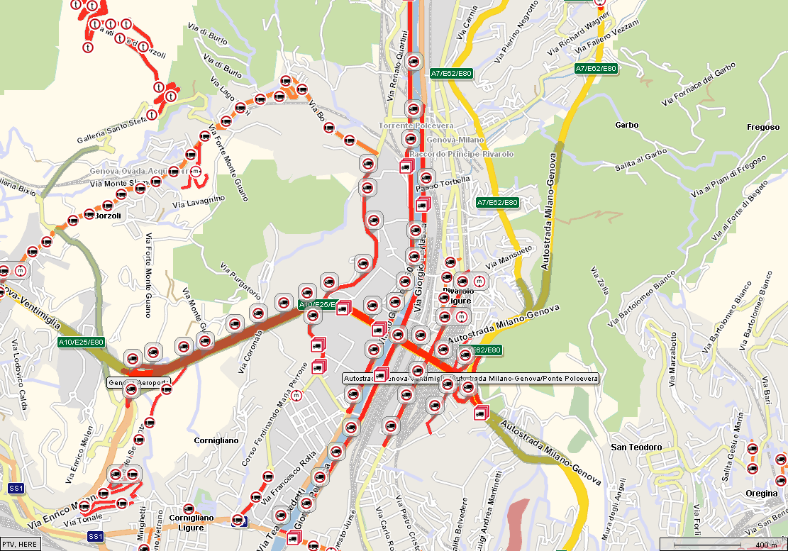

On the left side: a route that avoids the critical segments by applying the PTV_TruckAttributes layer<br />On the right side: a route that uses critical segments and raises violations.
