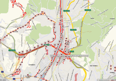

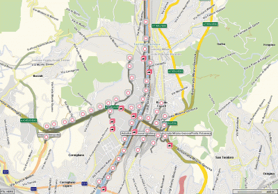

Visualization of the feature layer
By applying the additional data you can compute detours around the are of the incident.

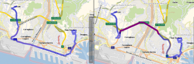

On the left side: a route that avoids the critical segments by applying the PTV_TruckAttributes layer<br />On the right side: a route that uses critical segments and raises violations.

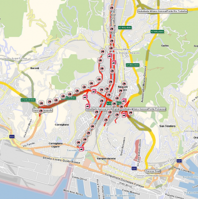

PTV_TruckAttributes
PTV_TruckAttributes
PTV_TrafficIncidents
