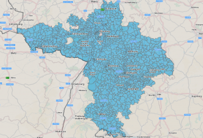

Issue :
Currently, we have border to each geometry shape present on the Active Region as shown below:

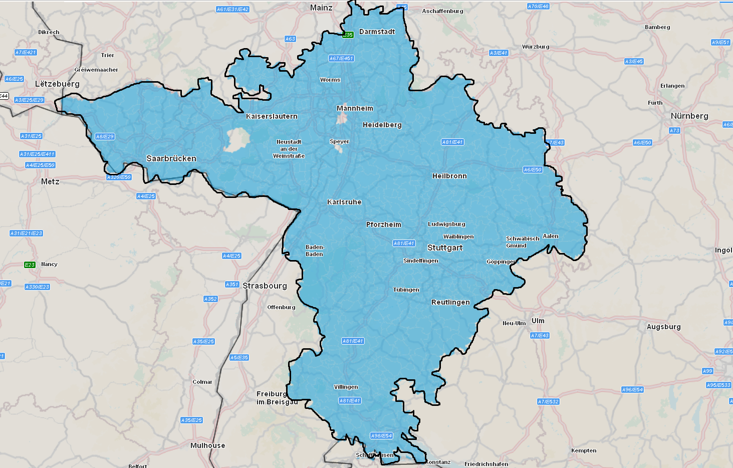

But we want to display only the outside border of whole Active Region, as shown below:
So is there any solution for the issue?
