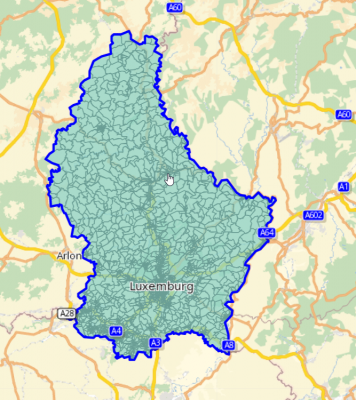

BTW, If you modify the sample
https://ptv-logistics.github.io/xserver ... ions-merge
to merge all polygons:
var newTopo = topojson.merge(topoData, topoData.objects.postcode.geometries.filter(function (d) { return true; }));
You'll notice the difference :D

We are currently working on Wpf standalone application, how can we use topology functionality in Wpf application ?

That's exactly the problem: There are no libraries for .NET comparable to those for JavaScript. There's some kind of port
https://github.com/Freddixx/TopoJSON.Net
you could use to display TopoJson in the control. But there's no merge() function available as far as i can see.
So i cannot see a way to perform realtime merging in C#, besides porting https://github.com/topojson/topojson-cl ... #topomerge or using some Interop to invoke the method from C#.

Thanks for the reply. We have used the NetTopologuSuit and GeoAPI & created a union geometry and saved union geometry binary in flat file. Later, we are using the flat file to read geometry data in display region in Map.
Currently it takes 3 to 4 to read geometry data file and display union geometry of large region on Map.
