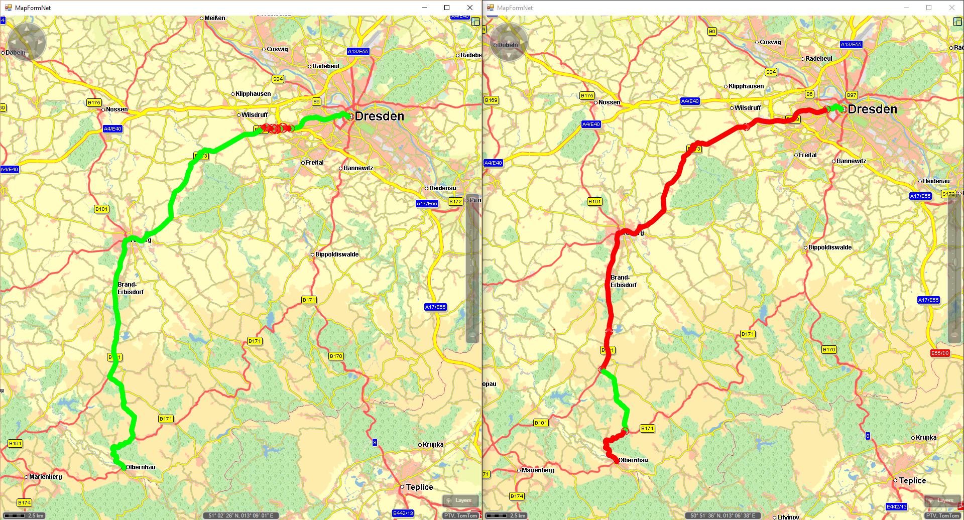

I was asked whether PTV is able to calculate the upcoming toll which applies on German Bundesstraßen from July 1st, 2018.
Yes we can.
Left: routing of a MG-truck-40t in the context of 30.6.2018 (before the switch).<br />Right: same route, same car but not in the context of 1.7.2018. <br />While most of the left route is &quot;without toll&quot; the major parts on the right are &quot;with toll&quot;.<br /><br />Toll values:<br />before: 3.7km // 0,57€<br />after: 58,6km // 9,13€
While most of the left route is "without toll" the major parts on the right are "with toll".
Toll values:
Just use the CountryInfoOptions property TollDate.^

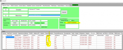

Of course there are many ways how to display toll costs. Here's a report I added to one of my test clients this morning:
report of the toll aggregated by streetname and further properties

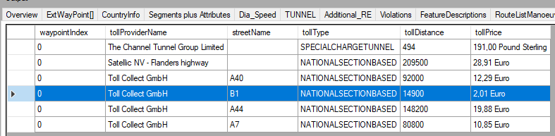

TollTotals - some meta values aggregated by country
