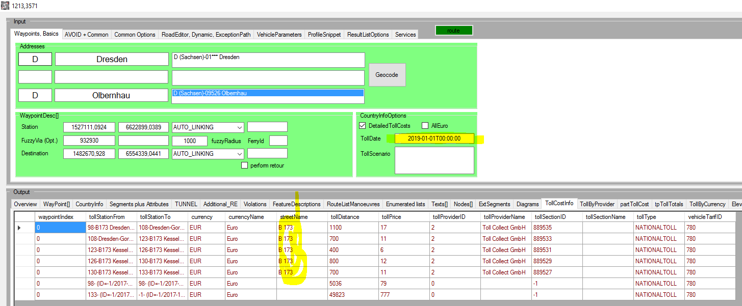

Of course there are many ways how to display toll costs. Here's a report I added to one of my test clients this morning:
report of the toll aggregated by streetname and further properties

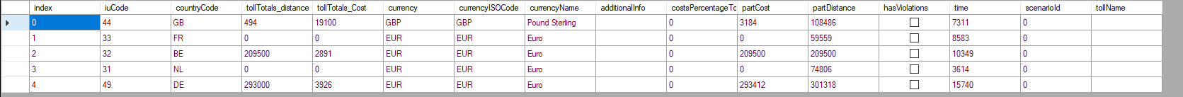

TollTotals - some meta values aggregated by country
