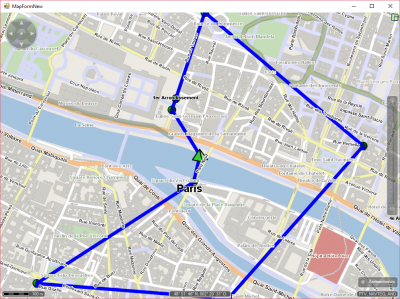

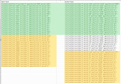

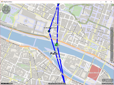

Thank you Bernd.
Another question about this.
In my test the new order are well added but the why the initial plan is not modified to reorder the tour points if it's better.
see xtour log attachement

Hello Michel,
from what I see in your request you deactivated all the sequencing and the improvement steps which might lead to further improvements.
Activate those steps and you get even better results.

YES.... of course !!!!!!!!
Thank you
