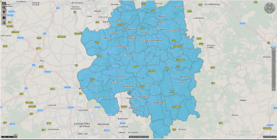

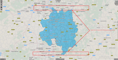

Active region is displayed in the center of the map as expected but some part of the region is still out side the map.
Find "ActiveRegionActualResult.png" which shows the current display of Map
Find "ActiveRegionExcpectedResult.png" which we want to display the Map in our App
