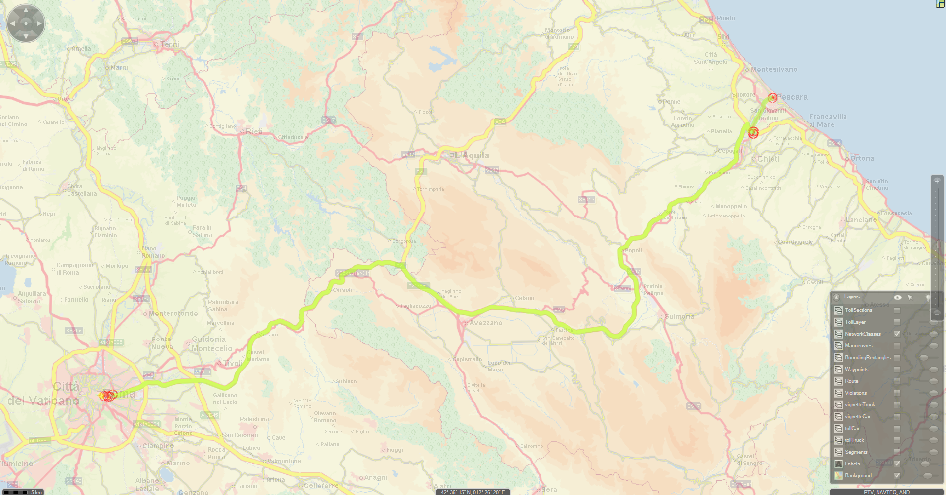

Hi, I'm having problems with highways recognition. I want to send a request to calculate a route and its alternative between different highways road crossings. I've found a json with all kind of manoeuvres and I've selected 4 different locInfoNodeType: AE, AS, AD, and AK.
But in italy the highways E80 and E70 seems that are not recognized as highways and so I cannot find the relative manoeuvres: The junctions between Pescara and Rome and Tortona and Alessandria aren't recognized.

I've set as start point bari and as arrive torino. I've calculated 2 alternatives routes the first route goes through E55 and the second goes through E45.
Now i need to find into the json in response all the manoeuvres that are AE, AS, AD, and AK.
Near Pescara and near Rome there is no kind of manoeuvre.

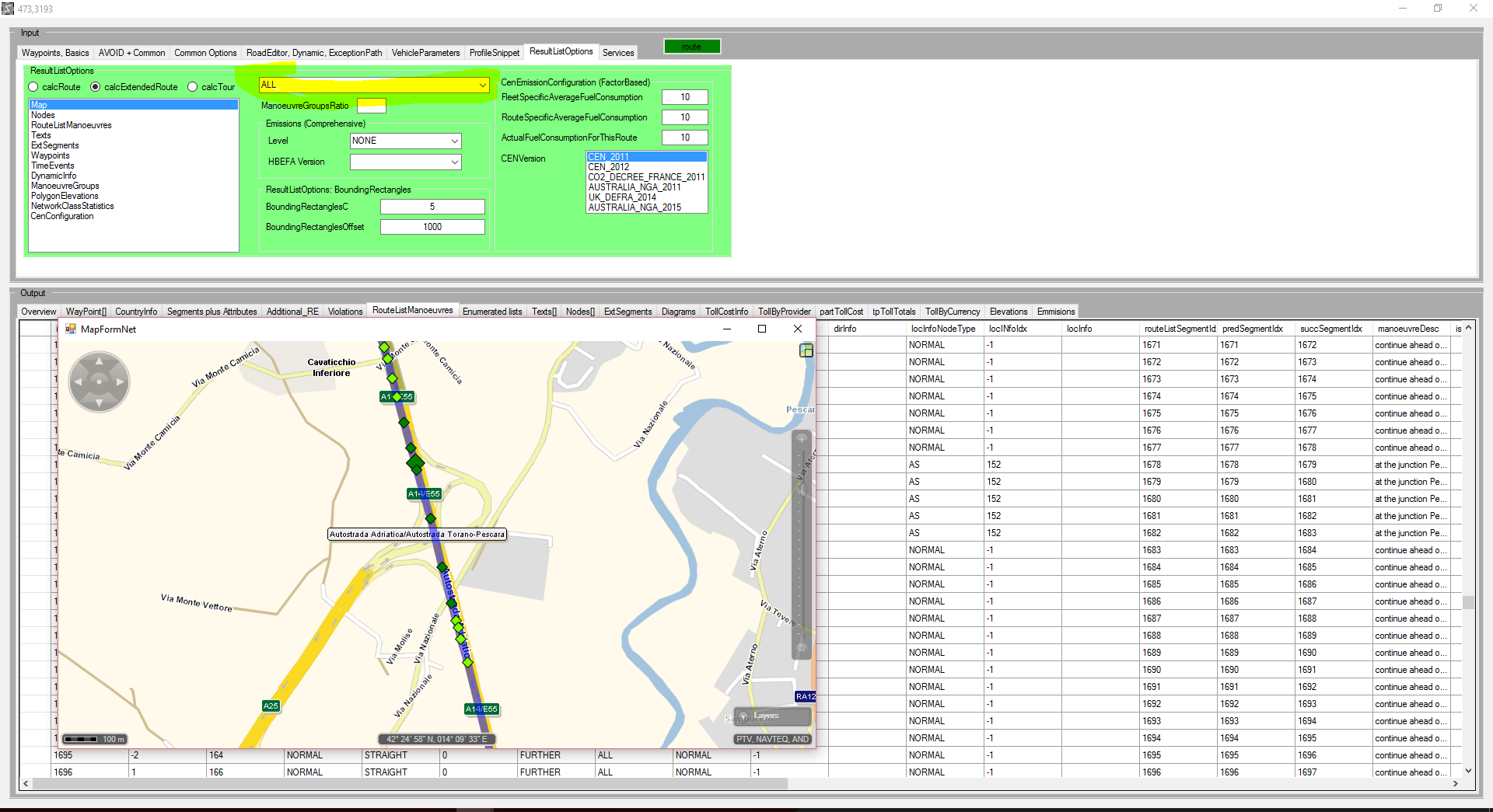

turned out that the solution for Gianbattista's issue is the ResultListOptions.DETAIL_LEVEL of the manoeuvres:
By setting it to ALL the response contained the required highway elements. They were missing because the STANDARD level only returns real manoeuvres where drivers have to change roads or lanes.
