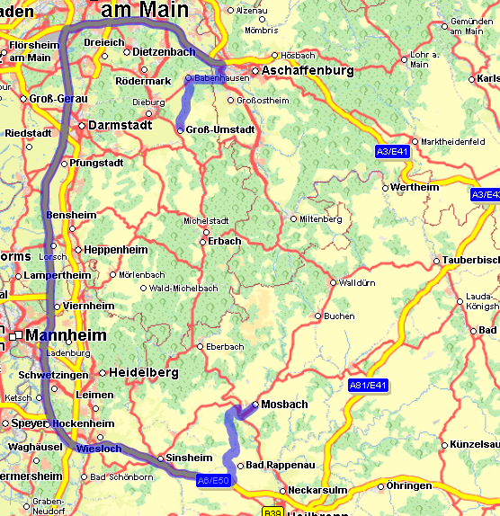

first of all: AVOID_HIGHWAYS=-99 is dangerous!
Routing with AVOID_HIGHWAYS=-99. As the costs of a highways segment are reduced to almost "no costs" the algorithm identifies how to get on a highway nearby and then wastes lots of detour kilometers.

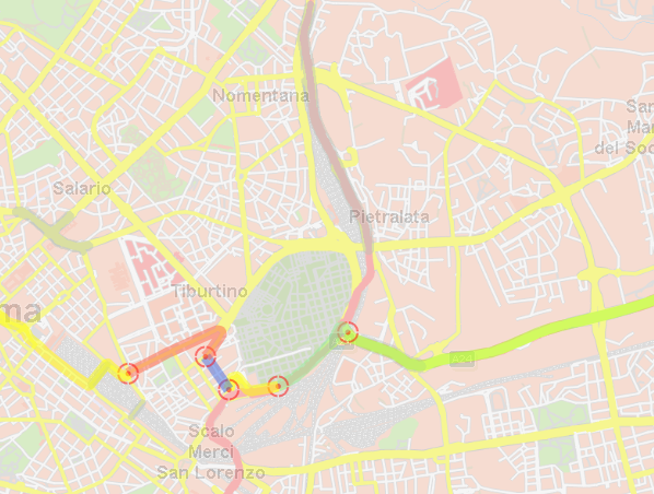

About Pescara to Roma:
Total track PESCARA to ROMA. Red circles show a change in the Network Class, e.g. from TRUNK ROAD to HIGHWAY.  So a very long part of the track is HIGHWAY.
There are several changes in the east
...and in the west in ROMA.
As the long track is highway I'm not sure what you miss.

turned out that the solution for Gianbattista's issue is the ResultListOptions.DETAIL_LEVEL of the manoeuvres:
By setting it to ALL the response contained the required highway elements.
Screenshot via XRouteToll testclient
They were missing because the STANDARD level only returns real manoeuvres where drivers have to change roads or lanes.
I added different colors (based on locInfoNodeType) and size (detailLevel) in my manoeuvres layer.
