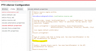

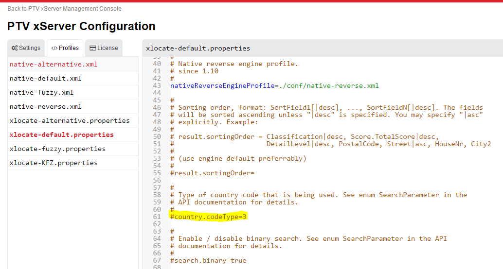

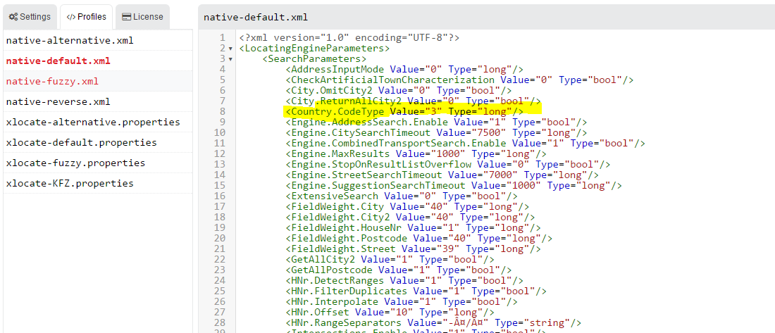

the parameter mentioned by Jochen is available in the xlocate-default.properties in the /conf. You could also change it in the native-default.xml. Just take care of the priorities of the resources. Here are some screenshots.
native-default.xml
native-default.xml
