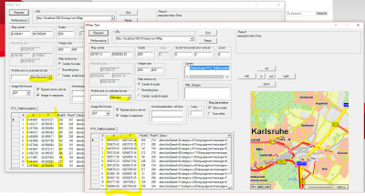

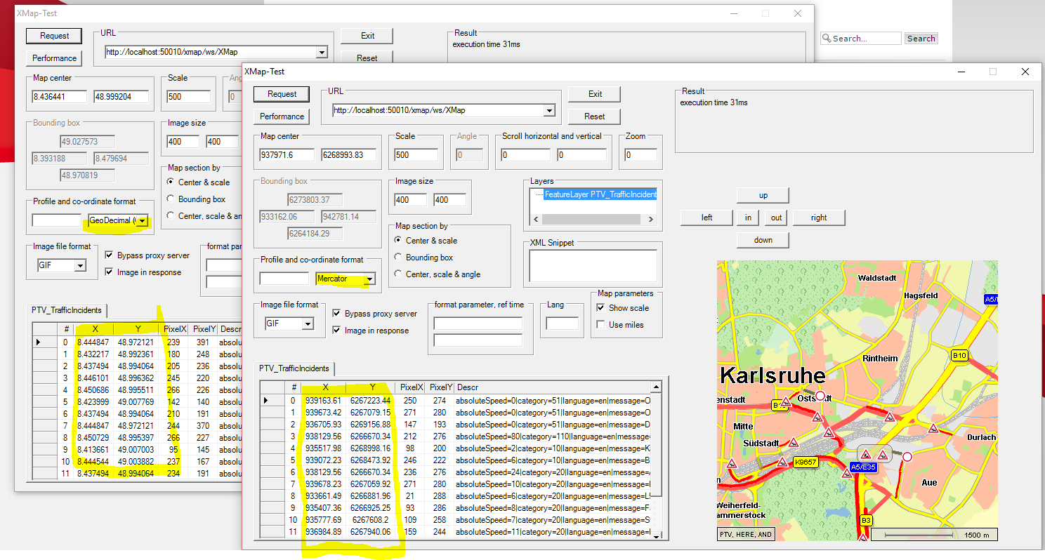

And how about "PTV_TrafficIncidents" FeatureLayer, there is a example result:
"absoluteSpeed=40|category=61|language=en|message=A49 southwestern at Kassel left lane closed|length=1428|startX=4380690|startY=5547109|language=|incidentId=TTI-1a4962c4-0c5f-4be8-98dd-0e5c3d768f51-TTR121843417011584-2_1"
what is exactly the "startX=4380690|startY=5547109", and how to get the coordinates from it (the best for me is just to get latitude, and longitude)?
I see it here:
http://xserver.ptvgroup.com/fileadmin/files/PTV-COMPONENTS/DeveloperZone/Documents/xServer_public/manual/Default.htm#FeatureLayerContent-Documentation/featurelayercontent.html#PTV_TrafficIncidents%3FTocPath%3DTechnical%2520Concepts%7CAbout%2520Feature%2520Layer%7CLayer-Specific%2520Properties%7C_____5
however there no explanation in it.
Posts: 3077
Re: Result of renderMapBoundingBox, wrappedObjectsField prop
As the string returned as "objectInfo" is rendered at feature layer design time (on data center) we do not know whether you requested the map tile in OG_GEODECIMAL or PTV_MERCATOR or whatever: It is simply stored in PTV_SMARTUNITS.
But:
If your mapping interface works with OG_GEODECIMAL you can have a look at the ObjectInfos X,Y-Coordinate property:
comparison between different coord formats
