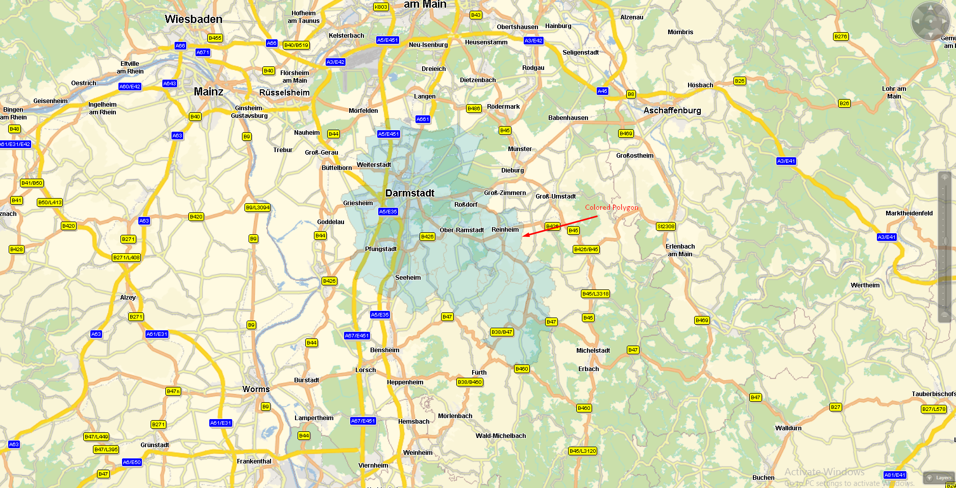

- We have specific polygon colored in the light blue color.( ColoredRegion.png )
- We have collection of points in database for that colored region.
- We want to color the whole region outside the colored polygon as gray.
Setting the background color of map.

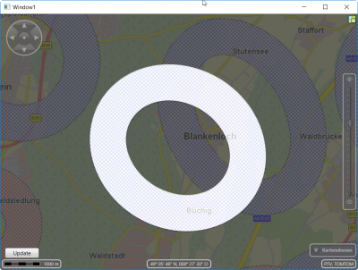

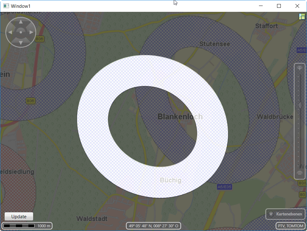

sorry for the late answer, but this is a tricky one. Of course you can set the opacity of the basemap layers to reduce the background, or you can draw a semi-opaque rectangle on-top of the basemap-layers.
But if you really want to highlight a distinct polygon against the background, you have to draw the "inverted polygon" in a different colour. This a bit complex, as you need to use topology operations, together with a custom canvas for the mapControl, as the standard MapPolygon of the Control cannot render this inverted polyon.
Here are the lines that show this practice.
https://github.com/ptv-logistics/xserve ... #L100-L117
You can download the code at the repository https://github.com/ptv-logistics/xservernet-bin
Regards
Oliver
