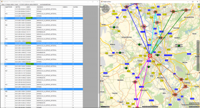

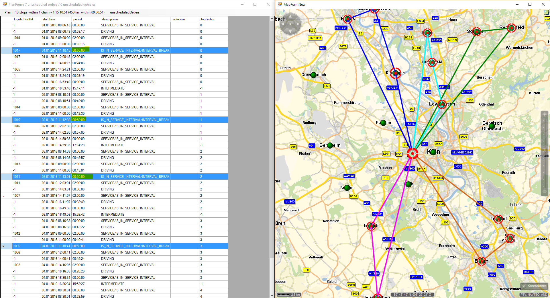

Here's an example:
and for the vehicle:
Here is the result
Looks great, doesn't it?
