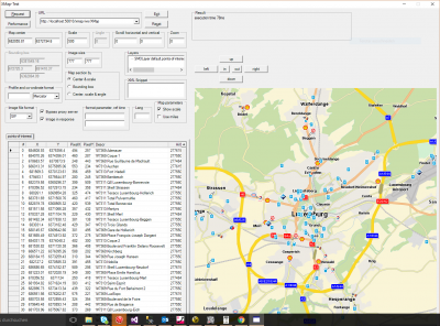

PTV can offer so-called POINTS OF INTEREST which contain various categories such as
- 7369 - Open Parking Area
- 7313 - Parking Garage
- 7311 - Petrol Station
- cloud: e.g. https://xmap-eu-n-test.cloud.ptvgroup.com/xmap/ws/XMap contain this data
- on premise: you need additional POI data to visualize those objects.
http://xserver.ptvgroup.com/fileadmin/f ... _Types.htm
Further information is available at http://xserver.ptvgroup.com/fileadmin/f ... n%7C_____7
And here is a sample XML request for this:
<?xml version="1.0"?>
<Envelope xmlns:xsi="http://www.w3.org/2001/XMLSchema-instance" xmlns:xsd="http://www.w3.org/2001/XMLSchema" xmlns="http://schemas.xmlsoap.org/soap/envelope/">
<Body>
<renderMap xmlns="http://types.xmap.xserver.ptvag.com">
<MapSection_1 scale="500" scrollHorizontal="0" scrollVertical="0" zoom="0">
<center xmlns="http://xmap.xserver.ptvag.com">
<point x="682055.81" y="6372194.6" xmlns="http://common.xserver.ptvag.com" />
</center>
</MapSection_1>
<MapParams_2 showScale="true" useMiles="false" />
<ImageInfo_3 format="GIF" height="777" imageParameter="" width="777" />
<ArrayOfLayer_4>
<Layer xsi:type="SMOLayer" name="default.points-of-interest.default;featurecode in ('7311','7369','7313')" visible="true" configuration="" objectInfos="REFERENCEPOINT" xmlns="http://xmap.xserver.ptvag.com" />
</ArrayOfLayer_4>
<boolean_5>true</boolean_5>
<CallerContext_6>
<CallerContextProperty key="CoordFormat" value="PTV_MERCATOR" />
<CallerContextProperty />
</wrappedProperties>
</CallerContext_6>
</renderMap>
</Body>
</Envelope>Best regards Bernd
