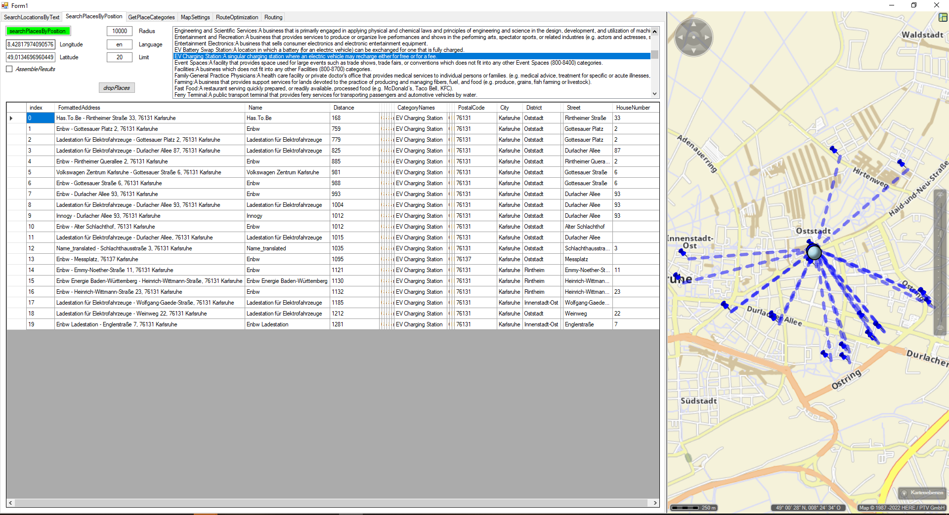

Recently I've been asked whether we can offer a search for EV charging stations (electronic vehicles).
As some of you might have noticed: there's no POI search in xServer 2 but we implemented this approach in the PTV Developer API which was released for PROD in summer 2021.
Result of a search for EV charging stations around the location of PTV's head quarter. I used the new PTV Developer API
For details check the documentation of the Places API.
