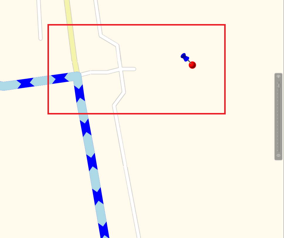

Hello

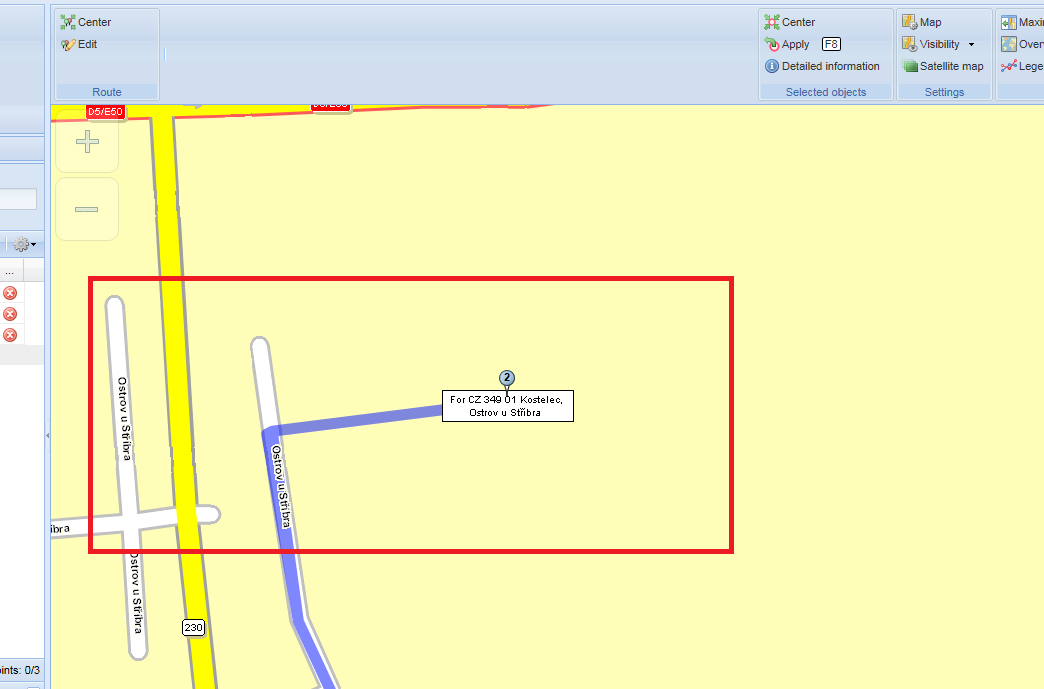

When planning a route for transit point, which lies off the road does not draw on a map the route. In Map & Guide Internet is route draw Ok. Why is it like this? Any wrong setting?
Wrong
Good on Map & Guide Internet

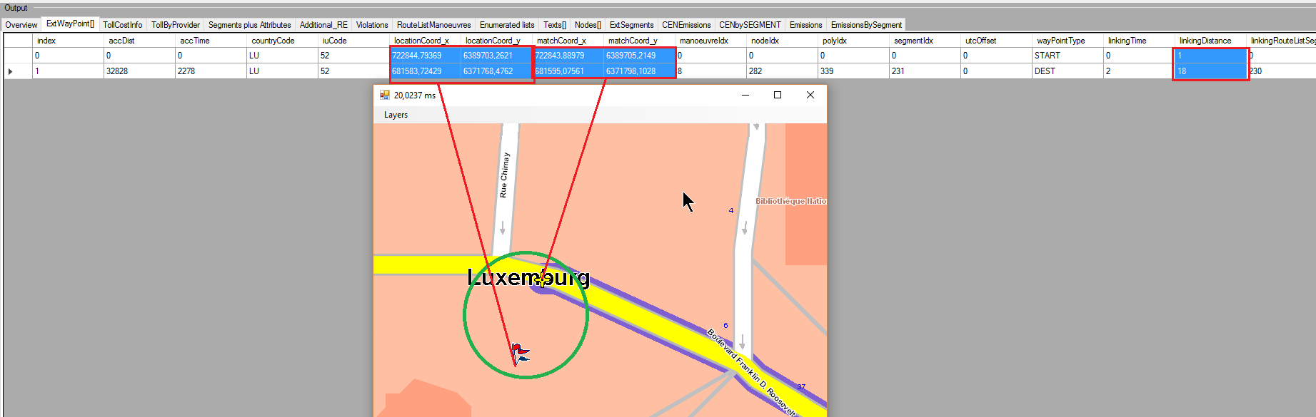

Hello Vlad,
how about this approach:
  • Use the RoutingOption.GENERATE_EXTWAYPOINTS=TRUE
  • This will extend the response and tell you the LOCATION coordinate and the so-called MATCH coordinate for each waypoint.
  • With this additional information you can paint the missing connection between input coordinates and the routing polygon.
The image shows the distance between LOCATION COORDINATE and MATCH COORDINATE. If necessary you can paint this airline connection.

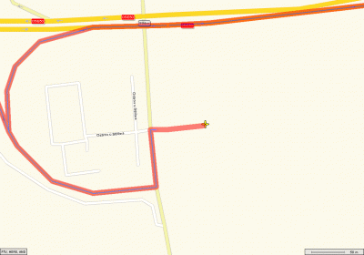

Re: Draw route on the map
And here is a little example, the yellow cross is the input coordinate.
The red line is your goal.
Little proof: the blue line is the polygon returned by the server.<br />The red line is the overlay of POLYGON and LINKING DISTANCE. Looks fine in my eyes.
