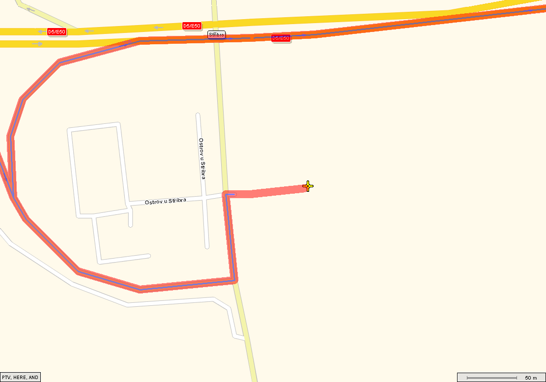

And here is a little example, the yellow cross is the input coordinate.
The red line is your goal.
Little proof: the blue line is the polygon returned by the server.<br />The red line is the overlay of POLYGON and LINKING DISTANCE. Looks fine in my eyes.
