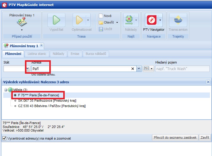

I have a question. It is a setting that will help me in searching coordinate foreign cities, using the Czech name. An example of using the Czech name "Paříž" (french Capital) to me function xLocate gave the name and coordinates of the "Paris" as it does Map & Gude Internet.

The functionality you are describing is default behavior. It is actually not possible to turn this off.
However: it only works of the translations are part of the map data. Since you where I asking the question I assuming that you are not getting the correct result so I took a closer look to the map data. Map and guide is using Here map data. In this map data the translation is available and Paris will be found. I also checked TomTom data and there the translation cannot be found. This is not something we can solve which settings.

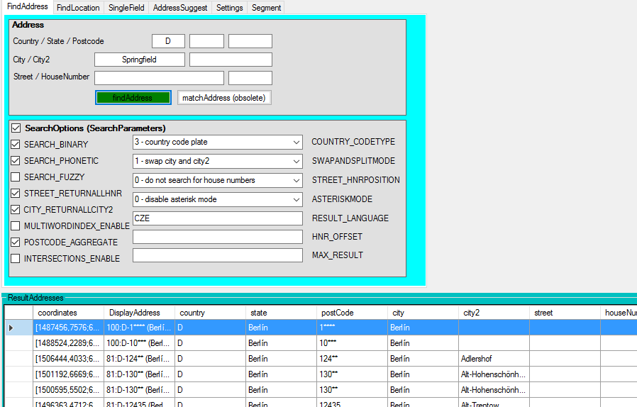

  • You can't specify the input language of an address property. Let's check this with the Bavarian city DEU:"München" which is ENG:"Munich" which is CZE:"Mnichov". Whether you provide the german, english or czech spelling: we try (and manage) to identify the city itself. So we determine each logical record in the database that matches the input.
  • Besides the national spelling of an entry we might have some translations into other languages. You can request the translation by using the search option RESULT_LANGUAGE.
  • To confuse you finally it is possible to look for MÜNCHEN by entering MUNICH and requesting CZECH translation which returns "Mnichov".
  • Still with me? If you need more stuff check the file CityAlias.txt in your map folder. You can add own entries over there so if you want to enable the geocoder to find BERLIN by entering SPRINGFIELD (in combination with DEU country) just add "Springfield~Berlin~DEU~". This will replace the input name SPRINGFIELD by BERLIN, then look for it during the real geocoding.
    Springfield~Berlin~DEU~<br />causes this weird search for the city of BERLIN
Let us know what further info you need,
