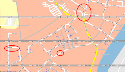

So I tried some requests...
This works, but there are no informations on the map
https://ajaxbg1-eu-n-test.cloud.ptvgrou ... -xxxx-xxxx

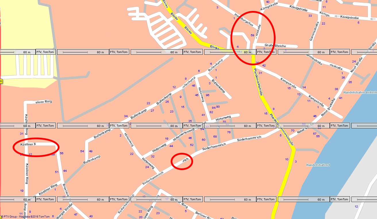

But when I tried this...
I got
As you can see, streetnames are cut and every request brings the cards legend.
What can I do?

I found a (first) solution
I use the Style xmap-tiles there is no card legend.
But the Streetnames are allready cut.
If you use the file servers of OSM, Google or Bing, there are no problems.
