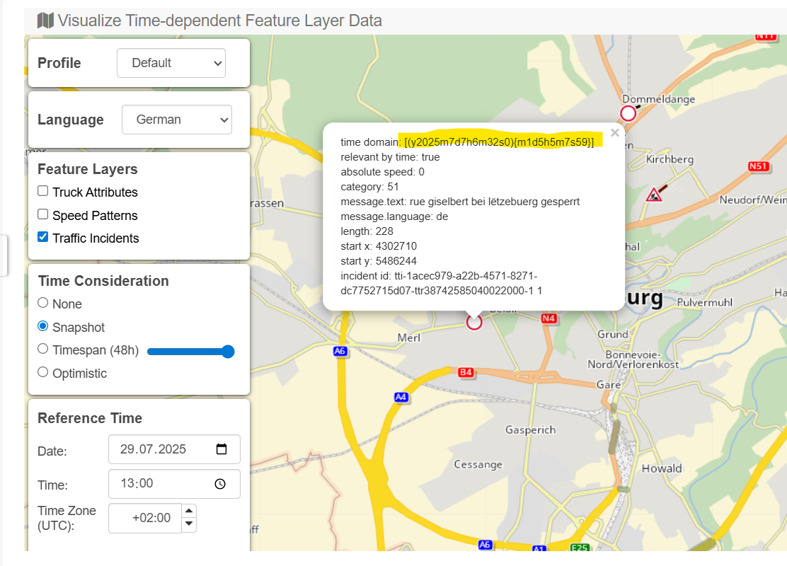

- Historical information: this data source considers data aggregated over a period of 2 years and enables users to get a time dependent "average" road condition at a specific point in time. This makes a segment's condition different if you compare a regular Monday morning rush hour condition with a chilled Saturday night condition.
This data is covered by PTV_SPeedPatterns (cars) and PTV_TruckSpeedPatterns (trucks, lorries) - Life traffic incidents: this data comes from TOMTOM's HD traffic stream and is updated every few minutes. It contains a clear beginning/end:
- planned construction sites with a known scheduled beginning and end of the activity, sometimes just a few hours, sometimes up to years (e.g. Rahmedetalbrücke at the A45).
- "Spontaneous" stress conditions such as "traffic blocked by an accident", usually for a comparably short period of a few hours.
These blockings apply only on a small part of the road network. They are contained in PTV_TrafficIncidents (coverage might depend on a country in the current scope) - Live Traffic Flow (aka "Level-Of-Service"): now that's the tricky part. Level of service usually means an almost LIVE condition of almost all the roads in a supported country. The reason for a potential degradation is often not relevant and the time reference is "right now"...
This data is currently (July 2025) not available through PTV APIs
- AVERAGE: focus on historical data
- REALISTIC: both historical and live traffic incident data
