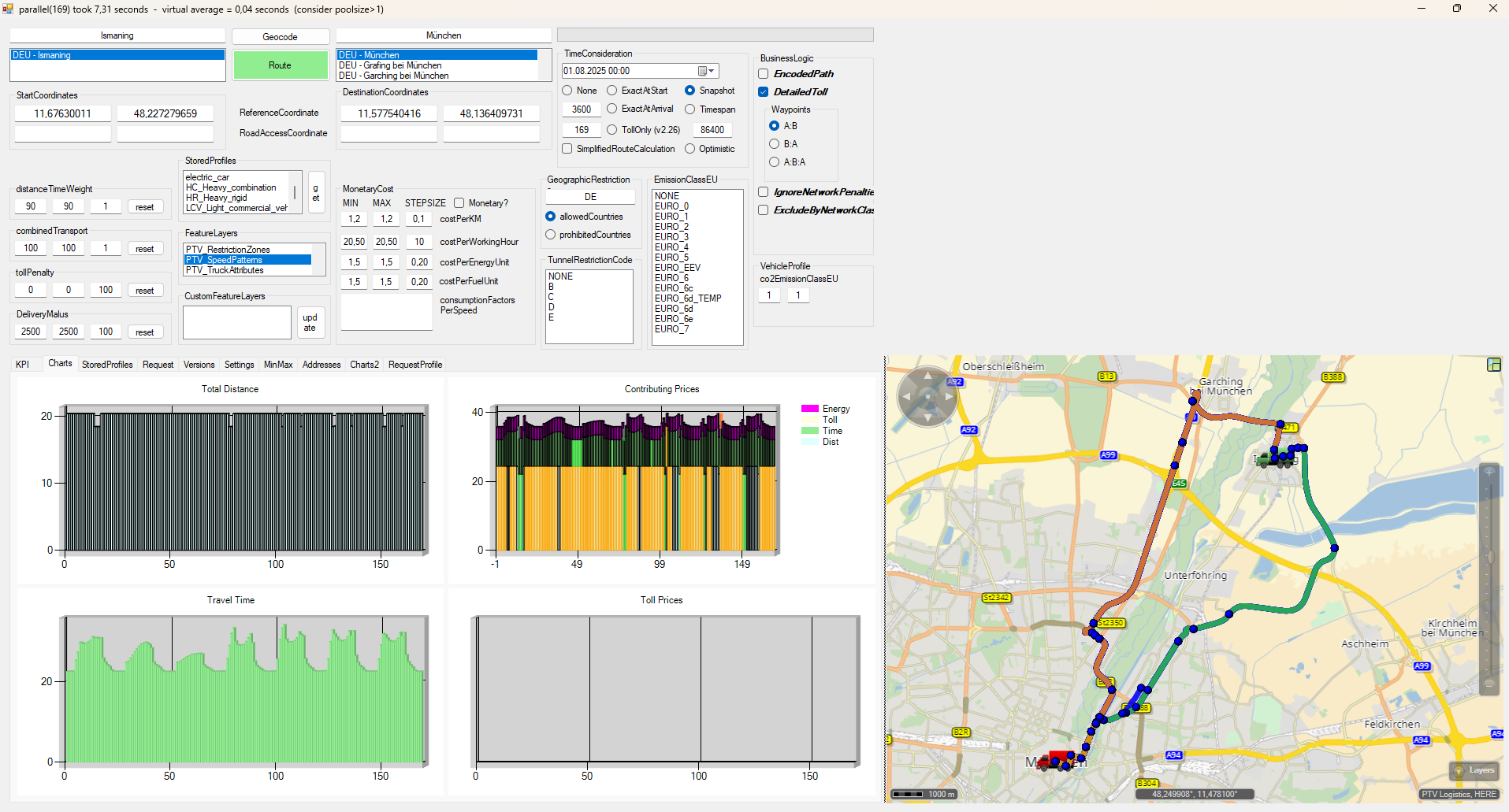

xServer2: historical data: picture shows the results of one week, 1 routing per hour. The chart shows the peaks on the weekdays in the morning and afternoon. Furthermore the "optimal route" depends on the time of the day - not only the "time required for a relation".

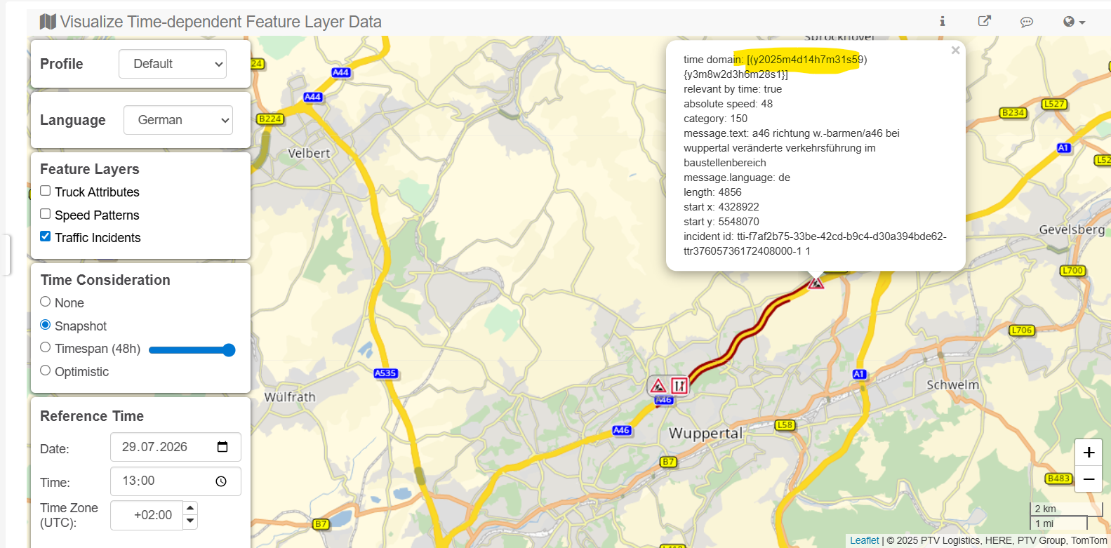

xServer2: Longterm incident - a construction site which is still  active in a year from now

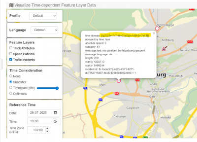

xServer2: Traffic Incident

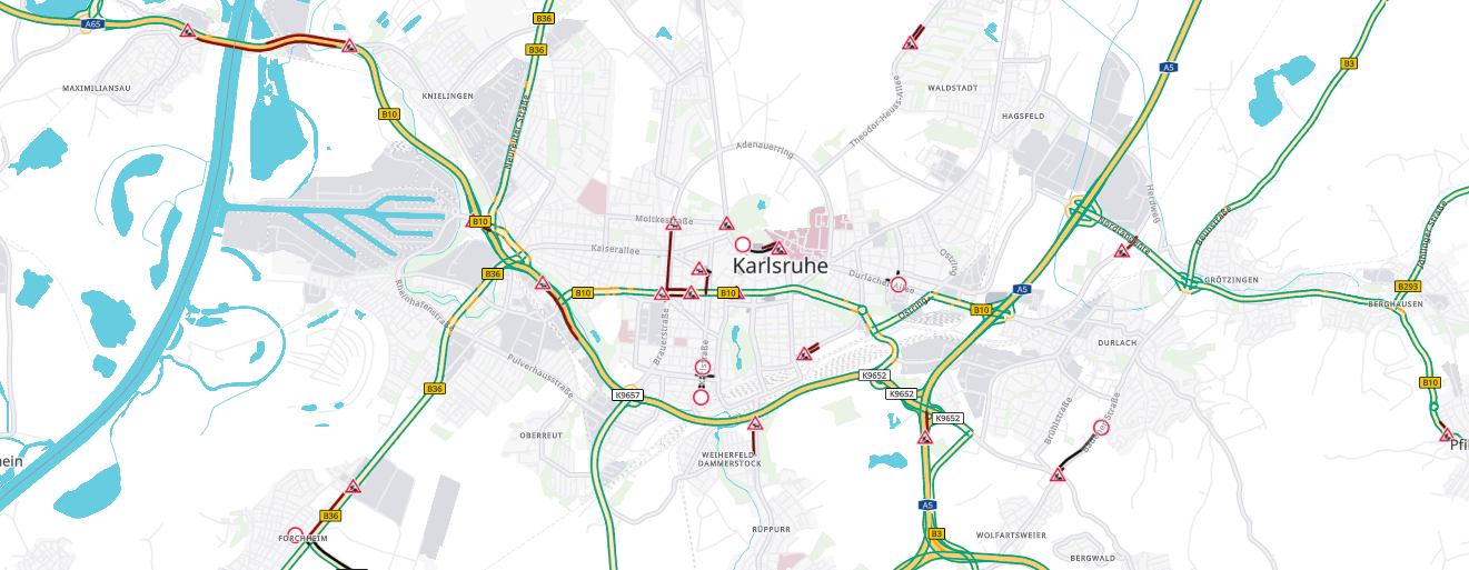

Roads in green/orange: historical speed patterns.<br />Traffic sign icons: tomtom hd traffic incidents
