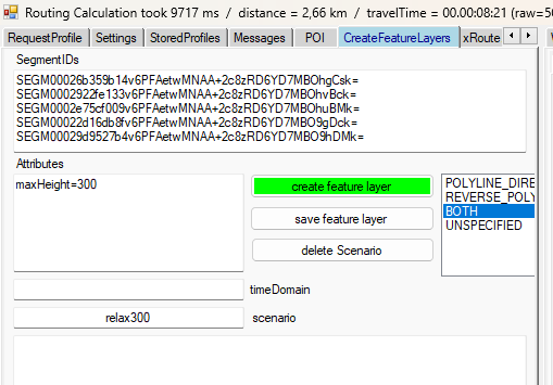

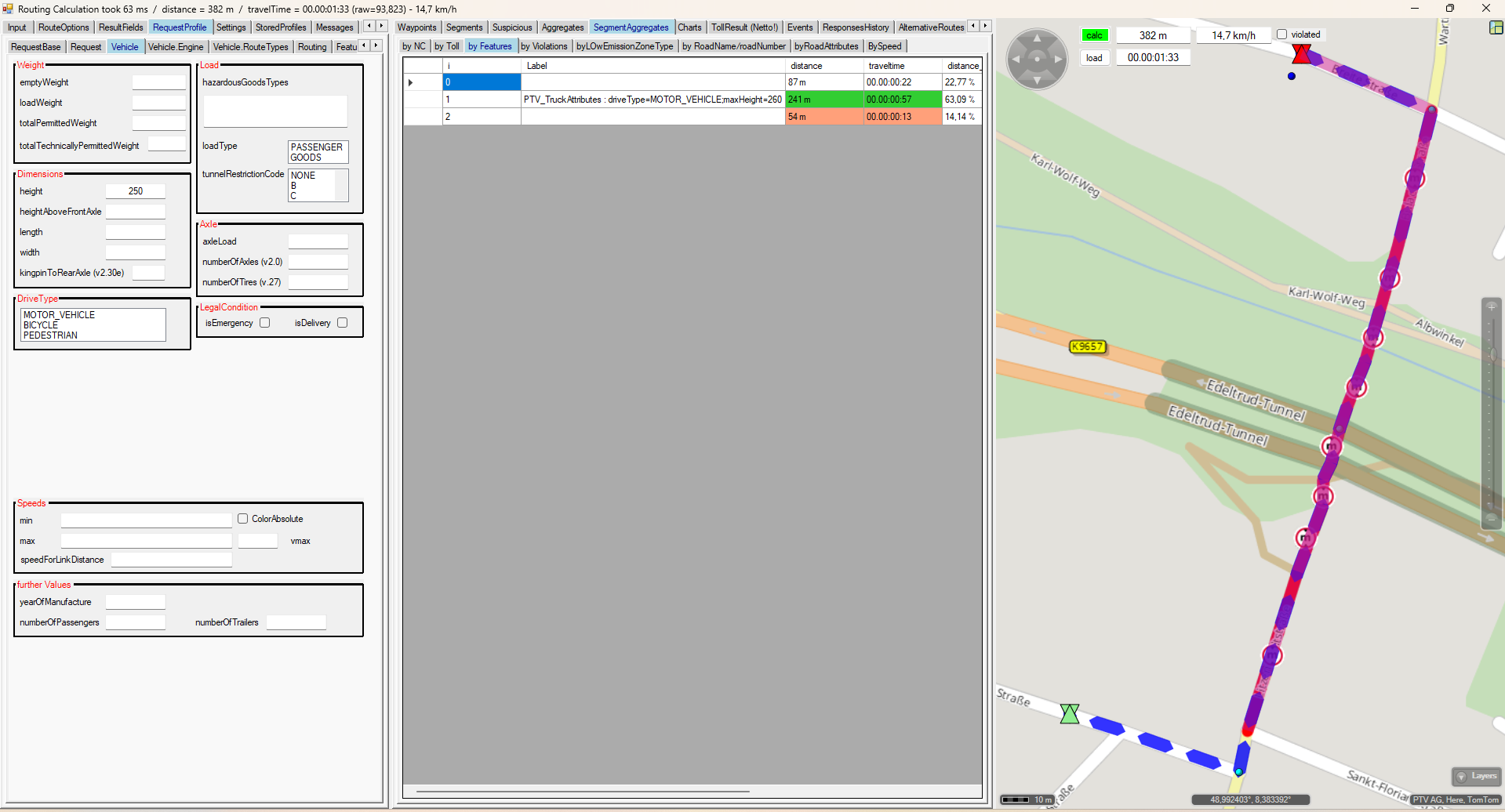

Here's an example for the feature mentioned in xRoute
Feature: Added support for relaxing Feature Layer attributes with custom Feature Layer like raising the height of a bridge and no longer the most restrictive attribute is valid.
  • Original TruckAttributes below the major road are set to maxHeight=2.60m, vehicle's height is 2.50m
  • With a vehicle height of 2.75m: detour
  • Created a new segment attribute with a relaxing value of maxHeight=3.00m
  • No detour required with a vehicle of 2.75m height
