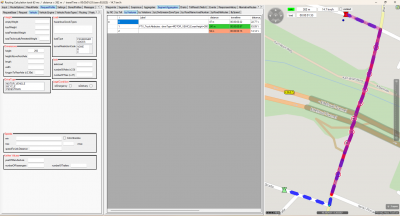

  • Original TruckAttributes below the major road are set to maxHeight=2.60m, vehicle's height is 2.50m

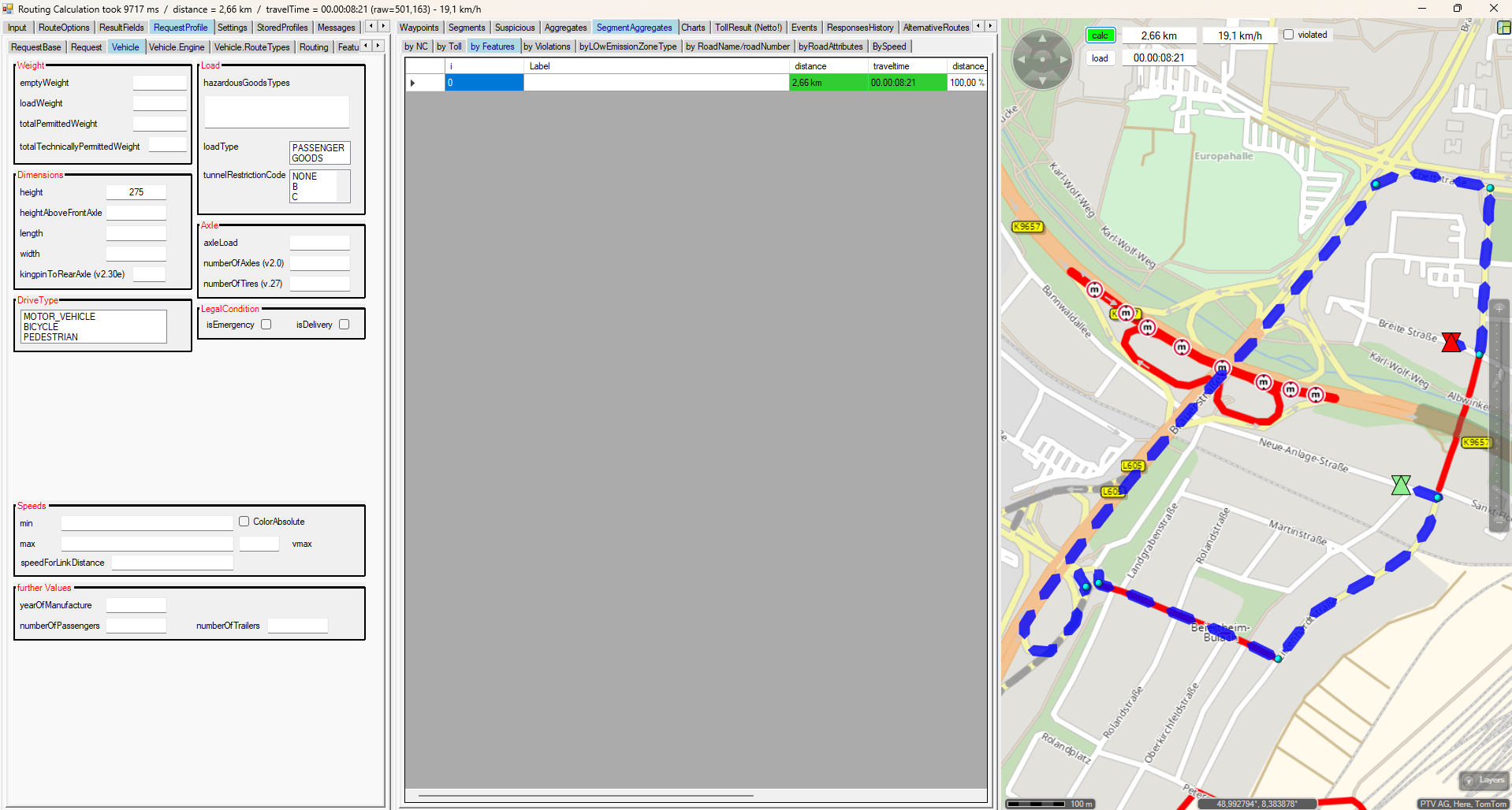

  • With a vehicle height of 2.75m: detour

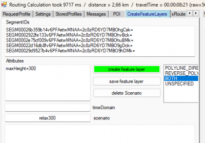

  • Created a new segment attribute with a relaxing value of maxHeight=3.00m

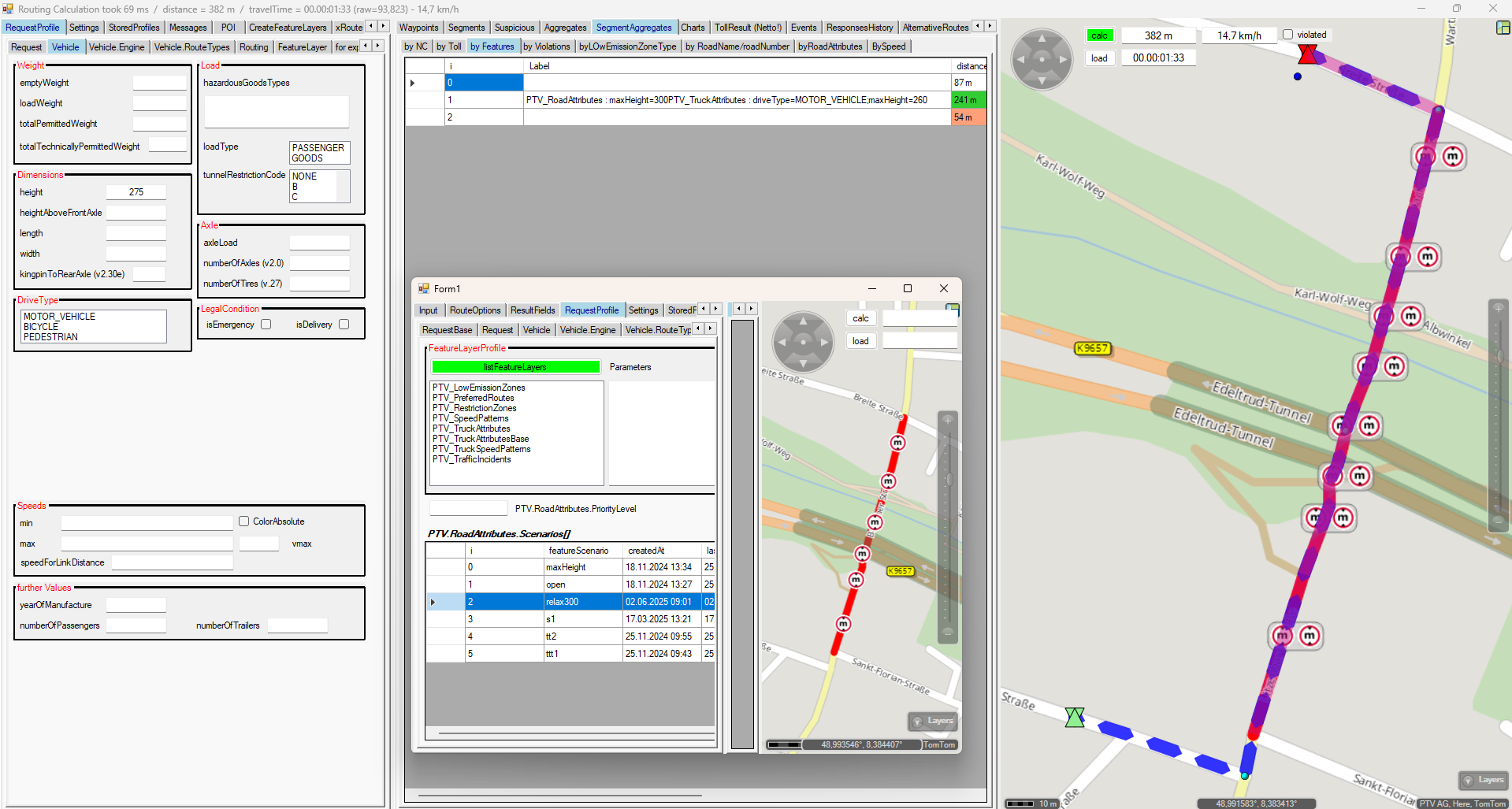

  • No detour required with a vehicle of 2.75m height
