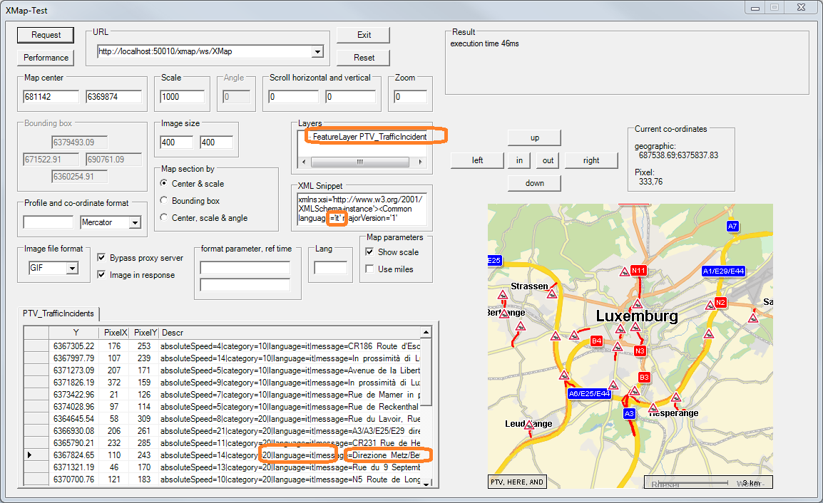

Yeah, meanwhile we identified the cause for the issue:
The process described by Martin refers to two non-equal containers:
  • The XML Snippet parametrizes a FeatureLayer-based resource and translates it into ITALIAN - but does not request the text messages, this is why they do not appear in the response.
  • The XMap Layer is of type SMO LAYER and is responsible for the visualization of text messages (see ObjectInfos) - but does not translate them into a NON default language. This is why they appear in the wrong language
The solution for this is:
Use one and the same container based on FEATURE LAYER to display the VIs and to request the messages in the proper language.
XML sample request image
Best regards Bernd Welter
