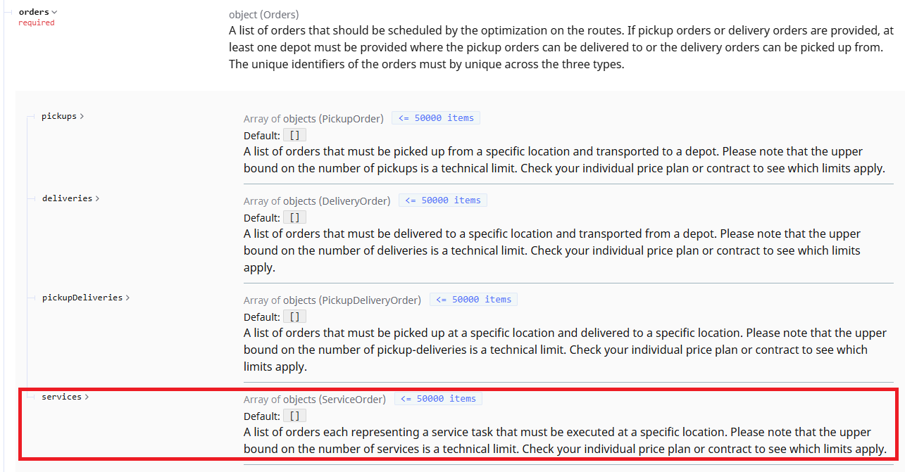

Tadaaaa - we now (v1.32 / 5.11.2025) support a dedicated order type called ServiceOrder!
