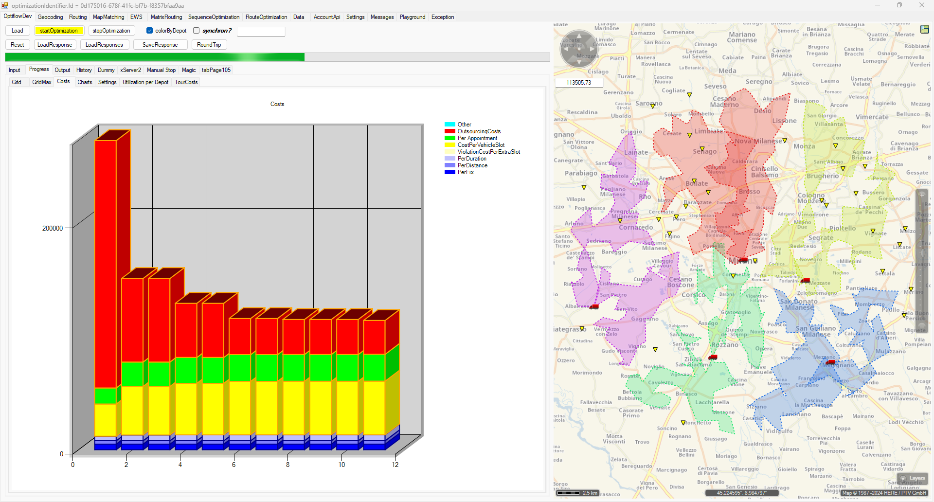

Decrease of total cost during a 1min planning (gathered every 5 seconds). This visualization shows the different contributions including the decrease of unscheduled orders (red).

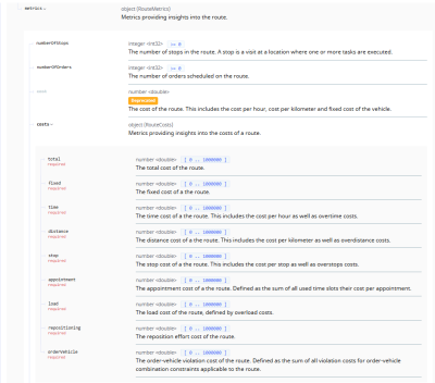

With version 1.37 you can now get more detailed infos about the costs produced by a certain route from the Response:
  • total : The total cost of the route.
  • fixed :The fixed cost of a the route.
  • time : The time cost of a the route. This includes the cost per hour as well as overtime costs.
  • distance : The distance cost of a the route. This includes the cost per kilometer as well as overdistance costs.
  • stop : The stop cost of a the route. This includes the cost per stop as well as overstops costs.
  • appointment : The appointment cost of a the route. Defined as the sum of all used time slots their cost per appointment.
  • load : The load cost of the route, defined by overload costs.
  • repositioning : effort
  • orderVehicle: The order-vehicle violation cost of the route. Defined as the sum of all violation costs for order-vehicle combination constraints applicable to the route.

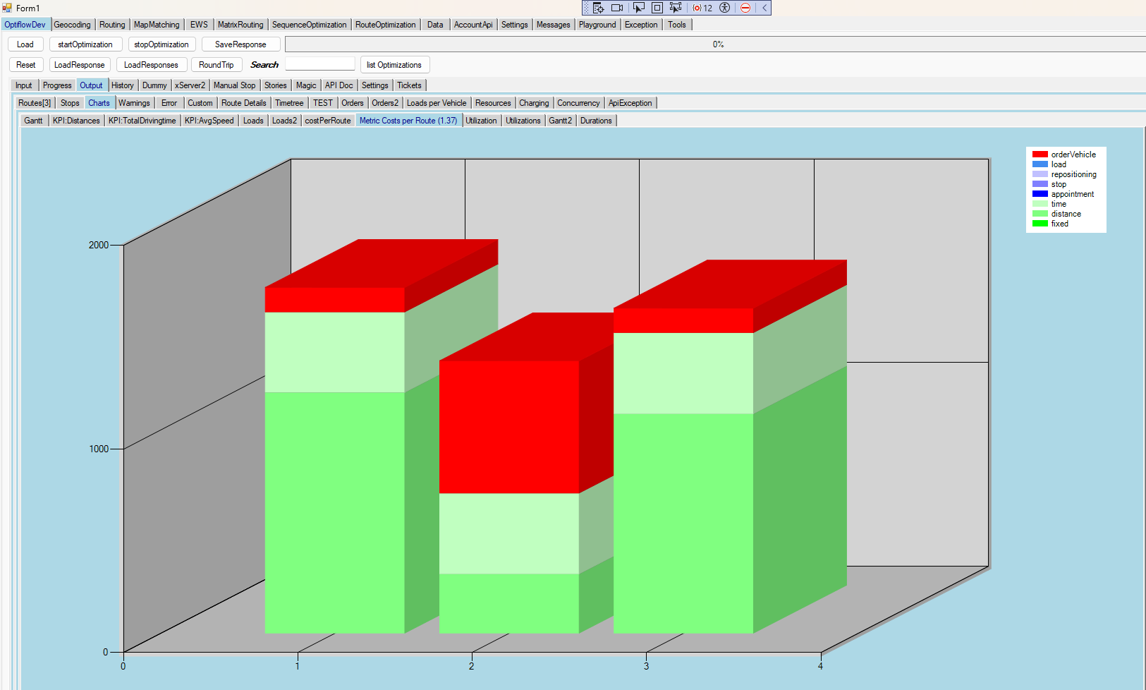

This enables you to create such charts and shows where exactly the money flows:
Check Result.Routes[..].Metrics.Costs:
PS: In the past did this on client side and
  • :idea: it took time to implement this!
  • :idea: it was time consuming to derive this valuable info from the input parameters and returned routes!

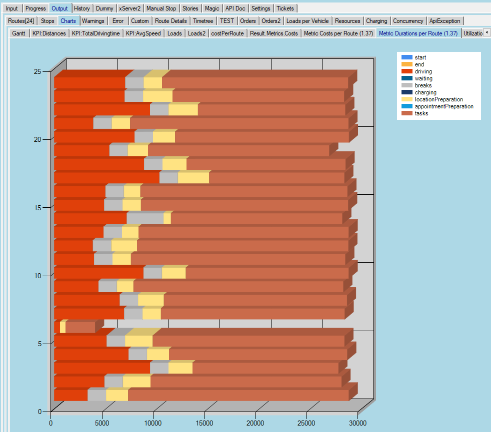

and we return the route metrics durations:
